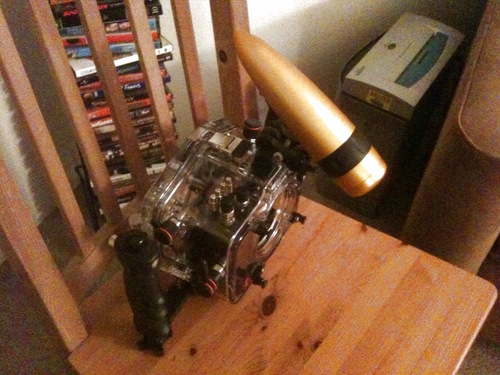

  2. I'm using the ultralight stud with just a single clamp (the normal one) connecting directly to the ball on my big blue focus light. I only have one dive on the setup so far, but it seemed to work reasonably well. Only gripe is that when tearing apart/assembling it's a little tedious to open/close the clamp each time. Really minor gripe though.
    Edited to show the setup. Realized I had a (poor) photo on hand.
