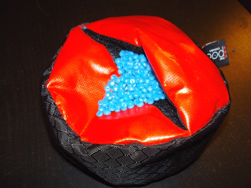

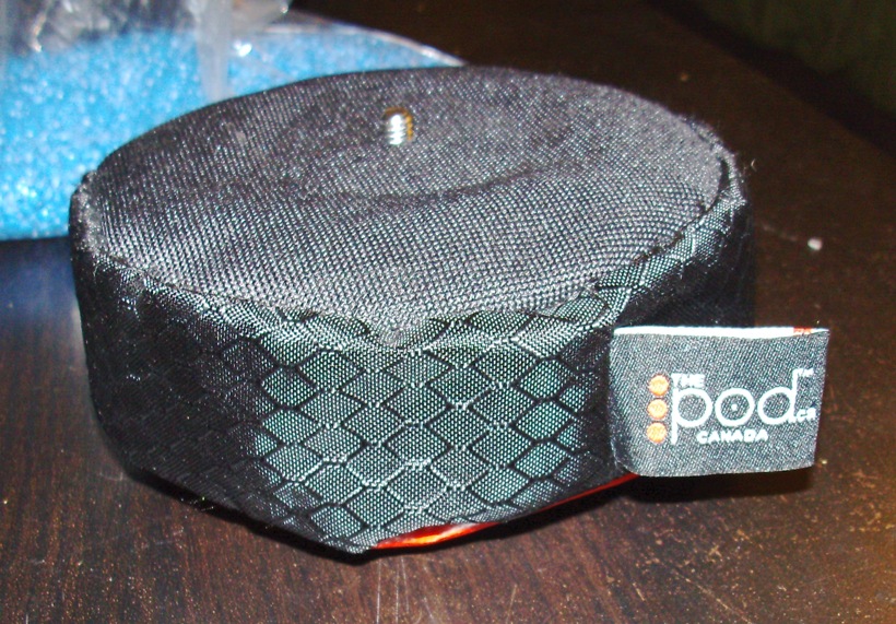

    There is this product called "the POD" which is to steady a camera on odd surfaces. It screws into the bottom of a camera (in your case a housing) with an build in 1/4 20. The unit is sold with small plastic beats/shot, which can easily be removed from the bottom by opening the velcro opening (see pics). It should easily be re-filled with lead shot weight pouch of your choice, probably up to 5#.
    This way you can adjust the right weight to gain neutral bouyancy, change it if your set up changes. And also in emergency flooding, release the weight and have your rig float too the surface...LOL (just kidding)
    Just another idea.
    Bo

    That's why you pay more for the POD, manufacturer raves about the bright blue plastic beads inside. I have not replaced mine with lead, since I like to travel light topside. ^_^
