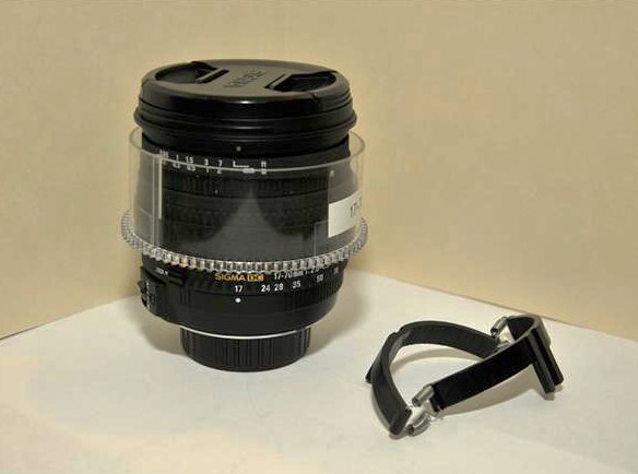

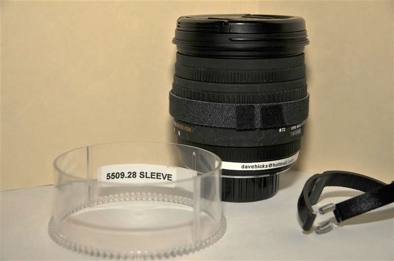

  8. I definately have the HSM version of the Sigma, and it does work in the Ikelite 8" dome. There is a caveat to this however. You can't use the normal spring collar that is supposed to mate up with the zoom ring. This would be too tight and the plastic collar would not fit. I just put a velcro strip around the zoom barrel of the lens, and then some extral little bit of velcro that line up with the tabs in the zoom collar. This works perfectly well, and it is very simple and maintainable.

  11. Neat!
    Would you mind posting some pictures on your home made velcro zoom thingy?
    I have a couple of photos of my Sigma 17-70 HSM with the velcro strap replacing the usual spring collar. I show the unused sping part on the side just for reference. The setup is very simple and allows the use of this lens in an Ikelite housing that would not otherwise be possible.

  14. I have a couple of photos of my Sigma 17-70 HSM with the velcro strap replacing the usual spring collar. I show the unused sping part on the side just for reference. The setup is very simple and allows the use of this lens in an Ikelite housing that would not otherwise be possible.
    Thanks for posting the pics. I just got the new HMS OS 17-70 and was weary on using the awkward Ikelite spring collar and scratching my new lens. This looks much easier and safer (maybe post in DIY forum?)
