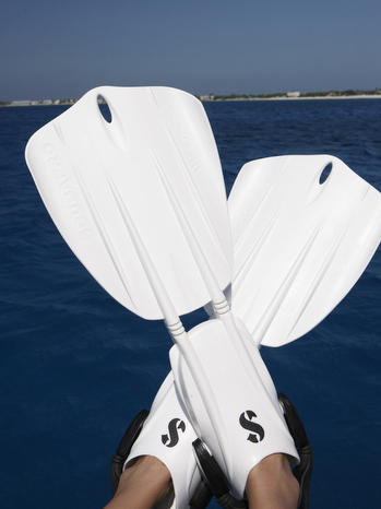

    You can shoot wide and prefocus on something like your fins. And if you use these fins, Scubapro Novas, you can probably knock out your white balance while you're at it.
