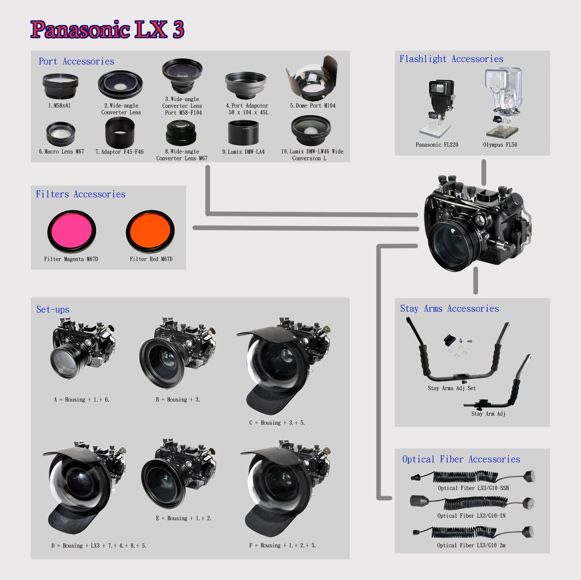

  7. Here's a chart that 10Bar supplied showing their w/a options.
    Jack

  11. The conversion lens port (#3) can simply be screwed into the port without all the disassembly to add the dome.

  13. Hey Jack, Can you tell me anything about #2 in the port accessories? What is the difference between #2 & #8? I assume they are both wet lenses that attach to the existing flat port (#1). And am I correct in thinking that #3 attaches directly to the housing (remove flat port #1)?
  14. OK guys, several choices there, some were older ideas as well it seems, so I made an informed decision...
    I will be stocking #3 the wide angle conversion port along with the screw on dome #5. This is a replacement port as opposed to the screw-on lens that made changing the camera out rather a process. The lens/port screws on, then if you want a wider idea you add the dome. This is the set-up C shown above. I'm hearing about 12mm with the set, should be very nice and flexible.
    I've brought a couple of sets into stock and they'll be up on the site as quickly as I can get some photos of them and their installation.
    Allen; I don't know anything about these W/A adapters, I would stick with the Panasonic or 10Bar. I can get the other items shown, but they have to come from HK.
    Jack
    Edited by JackConnick
  15. Here's some shots of the W/A converter lens port and add on dome.
    As I understand it the converter lens gets you back to about 24 degrees and the dome to 12 degrees (I could well be off on that). But for sure with sharper corners.
    You can use just the converter port alone, or with the dome. Both are DRY mount, cannot be changed uw.
