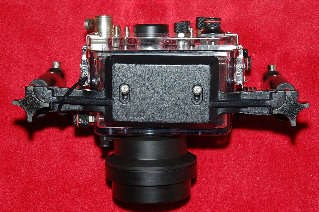

    I was under the impression that I had a pretty new housing (D300, approx 2.5 years old) but I can't see any holes in the bottom of the handle assembly.
    I've attached a photo of the bottom of my housing. What do you think?
    Is there a hole?
    If not, where should I drill and thread one?

  4. Here is the base of a D90 housing. The factory holes have some paint?? inside them and need a tap run threw to clean the paint out as seen in the center hole. Once the handles are removed you can better select a point to put the hole. I really don't think that placement is all that important as long as it will somewhat balance the rig.

    Thanks for the photo.
    I clearly have no factory holes. It will be another DIY project. The ocean is still frozen here so there is plenty of time. ;-)

  7. Here is the base of a D90 housing. The factory holes have some paint?? inside them and need a tap run threw to clean the paint out as seen in the center hole. Once the handles are removed you can better select a point to put the hole. I really don't think that placement is all that important as long as it will somewhat balance the rig.
    Glad I could help..
    I just spoke to my dive buddie. He has a D90 Ike housing and he has no pre-drilled-pre-threaded holes either!
    I wonder if the goods is strong enough to handle the system on a tripod, or if your base plate is not just pre-drilled but also made of another material etc!?

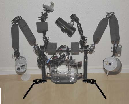

  8. How strong is the Ultralight triple-clamp? An easier way that might work is to put two "Ball with Ikelite Tray Mount" (part N on this page: http://ikelite.com/web_pages/arms.html ) and attach these to two triple-clamps (part AC-CTS at the bottom of this page: http://www.ulcs.com/armclamp.html ) and four arms with a decent length.
    With no current this MIGHT work, but I have NO idea if it will...
  9. My D90 Housing is new as of October 2009 that is why I have the threaded holes. Something new that Ikelite started. I would suggest that you drill and tap in the thicker areas for a tripod mount.

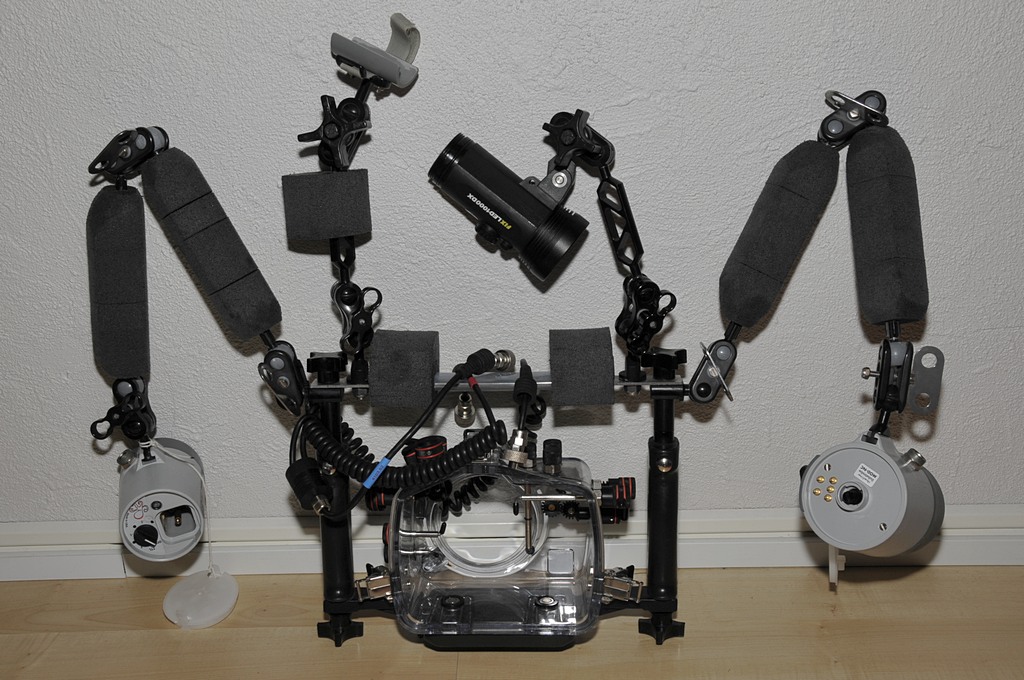

    Hmm the idea isn't bad. but my system is quite "buzy" already. I actually already use the N parts for my strobe arms.
  11. I Think you can mount two more n parts on the bottom of the handles.
  12. Peter. You are using (from the same IKE-page) a combo of G+N on the top. Right? I've always thought the Ns could only fit at the bottom of your handles. At least that's where I meant you to place them. Just like my pic shows (but with a triple clamp that is.)
