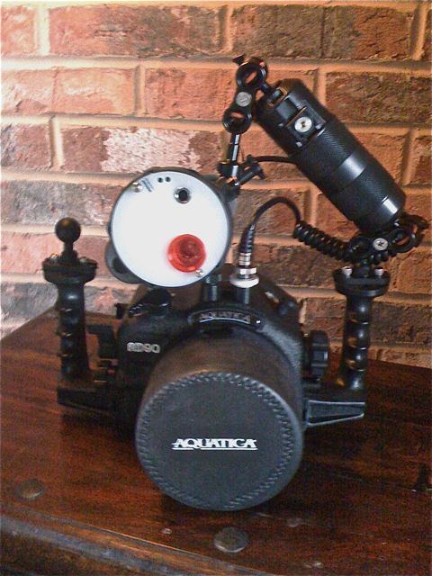

    I'm using a single 6" Inon float arm.
    Sorry its a bit off topic here, but I took a pic with my phone to illustrate my setup, but can't get pic to appear with text? what do I do??
    Probably simple I know, but would appreciate help.
    Andy.

  6. Hi,
    Andy.
    I think you need to upload it to some photo sharing service (picassa, flickr, etc) and then link it here.
    /Björn

  8. Hi,
    Andy.
    Figured it out!
    This is the image I meant to attach to the post above showing my macro configuration.
    Andy.

  10. Guessing you hit attach twice. Damn things keep doing what we tell them to do. :drink:
    Which arm is that Andy? I don't recognize it.
    Steve

    Hi Steve,
    Your right, I just realised my mistake!
    Its a Inon buoyancy arm, size medium (6") it offsets about 5oz of negative buoyancy.
