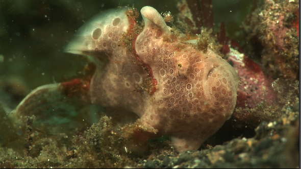

    Nick to me the m2t looked better to me (subject to the things about the translations above (4:3 issue) on the avi). If you like I can output the three streams to HDV for you to look at. Couple of screen shots to look at, JPEG so maybe not as clear as what I am seeing.
