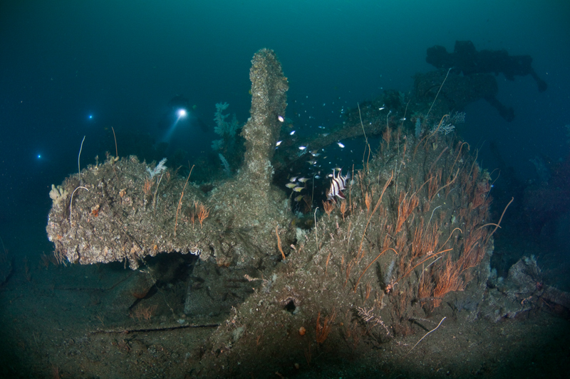

  2. Hi,
    Perhaps others have a different view but I'd consider the Tokina 10-17mm to be extremely difficult to use with a single strobe. I've attached an example of a poorly lit wreck with 2xDS125s with diffusers off.
    I guess it will ultimately come down to what you want to light and from how far away, but I'd find it quite difficult. Even with two strobes I find I find strobes I find strobe placement requires a fair bit of attention, which as shown above can come easily unstuck.

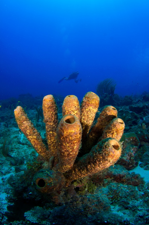

  3. HI,
    You can use the Tokina 10-17 (just as any other fisheye lens) with just one strobe. But not in any situation. You can light single isolated objects, or if you get close, also the whole picture. But it is hard to light a complete reefscape.
    Often even one strobe gives a nicer effect than two. It is just a question to use that one strobe effectively ... here a image i shot with the 10-17 and one INON z240 ...
    Greets, Serge
