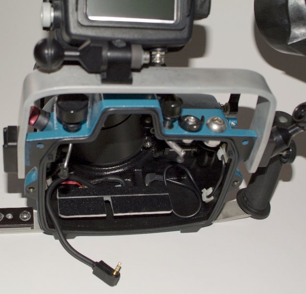

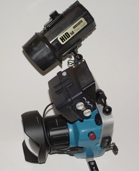

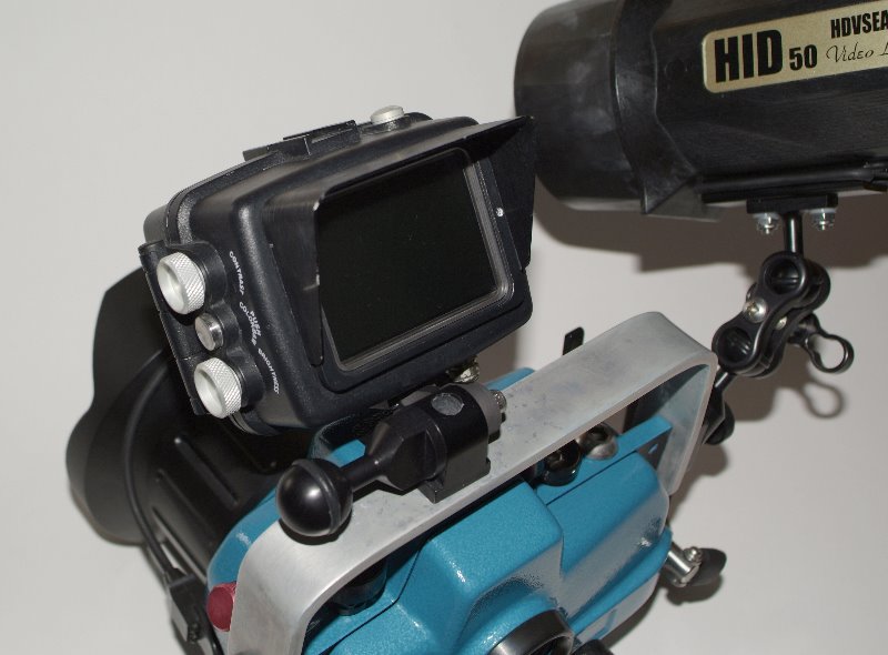

    I converted my old Subal F4 Pro case to take the Canon 5D2. For an external monitor installed the same Amphibico monitor I've been using for years with my Sony HDV setup.
    The Sealoc connector bulkhead was installed where the focus knob used to be...perfect location as it is almost flush with the side of the housing. Needed to replace the camcorder type AV plug with a mini jack to go into the Canon video-in socket.
    I didn't see much advantage in a HDMI monitor since the 5D2 only outputs in SD during video acquisition.
    By the way, I also installed a Gates hydrophone where the aperture control knob used to be. Works very well...even with the camera's AGC.
