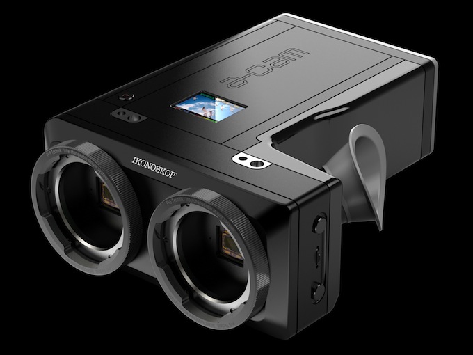

  1. Ikonoskop quietly released a custom built 3D camera based on their yet to be released A-CAM dII RAW HD camera. This 3D version can be custom ordered and will sport 2 of the S16 CCD sensors and record separate files in DNG, on an optimized body with lenses 91.5mm apart. Prices are POA. A 3D camera in such a small form factor is great news for uw filmmakers. Now what kind of dome is needed? I do think the Panasonic 3D camera will be of more use with AF and other functionalities.

  2. Now what kind of dome is needed?
    A big one :D .... wouldn't you just shoot from behind a flat port.

    I'm sure the issue of optics will complicate underwater use. Look at the IMAX 3D cameras... how big are those domes!
    With these smaller cameras, the domes would have to be almost madonna bustier like but then the sensor distance of 90mm doesn't make it easy. I'll leave it to the real engineers to figure it out. I'll just bitch about the lack of sharpness and become unpopular with them until they get it right. :D
  6. The way the fuji adjusts for parallax is to adjust the angle of the 2nd lens dependant on focus distance.. i agree Drew, let someone else figure out some kind of port that copes with that.. or shoot everything at a system's "sweet spot" distance.

  8. I'm sure the issue of optics will complicate underwater use. Look at the IMAX 3D cameras... how big are those domes!
    They don't use domes in IMAX 3D because the virtual image screws up the 3D effect on the big screen. I had a long conversation with Howard about this -- they tried it, but the effect was totally wrong in the theater (they used a dome that was nearly 3' in diameter, which added a few hundred pounds to the weight of the camera).
    I'll bet you could get away with it for small screen presentation, but large screen 3D is not very forgiving.
