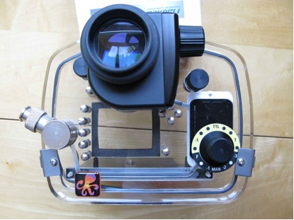

    As others have commented, the viewfinder itself is a very solid and quite heavy piece of kit and beautifully finished. There is a further minor snag when fitting the viewfinder to the Ike D80 housing which may or may not be problematic with other Ike housings. The viewfinder partially overlies the 9 o’clock and 12 o’clock direction pad buttons (see photograph). As supplied, the Ike 6 and12 o’clock buttons are longer than those at 9 and 3 and as the viewfinder is pushed home, the 9 o’clock button is operated. :( This is easily remedied by swapping out the long 9 o’clock button for one of the shorter ones elsewhere in the housing. This still leaves the two direction buttons partially obstructed by the viewfinder, which is not ideal, but my naked finger can adequately operate them. I think with a gloved hand that would be more problematic. The workaround here is to set the camera to “Focus Area Selection Wrap” (Custom setting #20) so that the obstructed buttons aren’t needed. The two command dials of course duplicate other controls that use the direction pad buttons. On the other side of the viewfinder, the clearance from the Exposure Mode Dial knob is minimal, but clearance there is and I don’t see that as a problem. However it does prevent the viewfinder from being mounted upside down to avoid obstructing the direction buttons.

    Above: Viewfinder fitted
