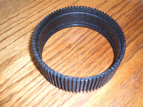

    Bill - There is a lip inside the gear. Would love to hear your suggestions.
    My husband made the suggestion to me last night to have him put set screws into it (he has a lathe that he could probably do this with).

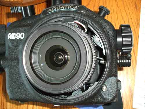

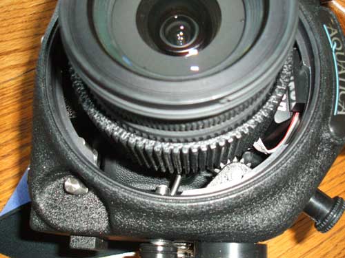

    Here are some pics I took with my P&S camera this aftenroon. There are not any set screws in this gear. I do not know if you can see it or not, but the gear is still not mating with the inside gear and it has already hit the lock button on the lens as well as the release knob for the lens inside the camera housing. Any thoughts are welcome as I wait to hear back from Aquatica and the place I got it from.

  12. Thanks for the support and letting me vent. I finally had time to sit down with Eric (my better half) today and work on the problem. He suggested that I grind the lock mechanism on the lens down (still usable) so that it did not stick up. So..I agreed and he did. The gear does not hit it now. I put it on and have moved the gears over and over to make sure it will not slip now.
