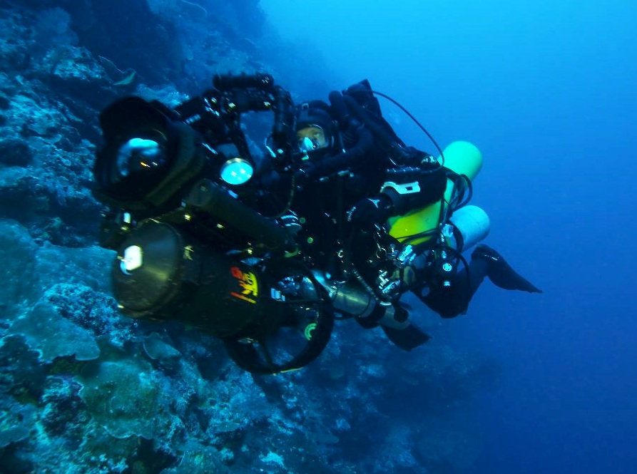

  4. If you want to film down to 100m then your options are seriously limited. Extreme pressures and low ambient light will require you to start looking at some of the higher end equipment.
    Start scrimping and you're going to end up with a soggy mess or gloomy video leaving you wondering why you even bothered.
    Here is a pic taken of me returning from a film shoot at 156m recently.

  5. Nice shot Lance! What were you doing down there?
  6. Nice shot Lance! What were you doing down there?
    We were out at Osprey Reef in the Coral Sea with a group of Scientists from The University of Queensland. Osprey Reef is an underwater mountain rising up from 1500-2000m and has some unique deep wave formations carved in it from before the sea levels rose, covering them. Since then the coral has been building layer upon layer and is now only just below the surface at low tide.
    The Scientists were interested in viewing these wave formations and I also retreived some ancient coral samples which are now back at the University being dated and analyzed.

  10. gee Lance, you got some gear there...lol
