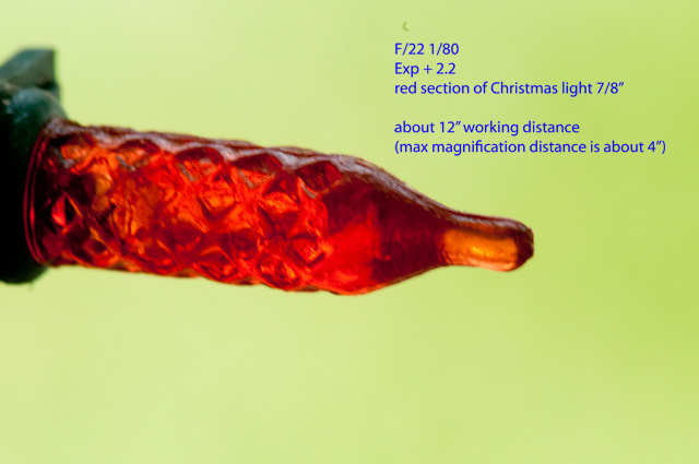

    Here is my preliminary impressions and testing of this combination: (everything is on land)
    First, sometimes the camer gets confused and won't auto-focus. I am not sure why but it seems to lock a minimum focus. However, if you move to minimum focus distance and get a view of the subject the autofocus will work. The focus is not necessaryly perfect, however. Hou must rock back and forth to get a true focus. I shoot in focus priority mode which means the shutter won't release until the camera has a focus. Any shaking or movement will prevent a focus and a shutter release. I would like to manual focus if a focus gear is available for my rig.
    I found with the Sub See +10 that getting to the minimum focusing distance and a 2:1 super macro means that the camera will have difficulty focusing and ANY movement will prevent a good picture. The 2:1 TC acted the same but with a longer minimum focus distance. However, my goal was not necessarly to get better than 2:1. Rather I wanted good magnification at a working distance of a foot or more so I could capturs small, skittish critters like a jawfish with eggs or a blenny out of his hole.

  3. Thanks for posting these Tom. Is the f22 what is showing in the viewfinder, or the "actual" f22, or are they one and the same on the Nikon?
    The image quality of the shot of the lightbulb sure looks low compared to the flower shot.

  4. Note the lightbulb shot needed two stops of increased exposure in Camera Raw. I think what really happens is that the iso is increased 2 stops. The F/stop is what appears in the EXIF data. That data shows the lens as 210mm.
