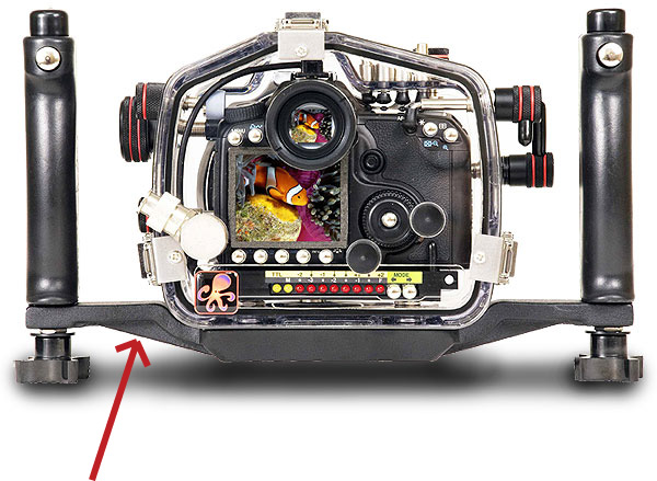

    I just travelled to Taiwan for some research and borrowed a pelican case from a friend for my 40d ikelite housing, arms, strobe, port etc. I packed the thing with foam to the best of my abilities but I didn't really think about padding the baseplate too much cause it was fairly snug in the case without padding. Well how wrong I was. The side of the base plate broke off in a similar spot in the picture I've attached. I've tried getting in contact with an ikelite dealer here in Taiwan but so far have had no luck. I'm thinking of trying to glue it. Any suggestions on glue? I'll be here for 2 months though the shipping isn't worth it to get one sent from the states. Thanks so much.

  2. Crikey. That must have been some whack to break that - or the casting was faulty in the first place.
    If you are using a strobe on that arm then glue isn't really an option but try an epoxy such as Araldite.
    Think I would take it down to the local scooter repair shop and see if they can make some sort of mechanical repair such as riveting/bolting a piece of alu either side of the web and along the top. Its very easy to take it off the housing.
  3. Yeah it was. I've travelled with pelican cases quite a few times and this is the first time I've seen a crack in any pelican case. Looks like it was dropped on entirely the right corner where the base was situated. Really happy all the other gear was foamed in place. The original foam that came with the pelican was cut to other equipment so I had to make my own and improvise a little. Anyhow, the side that broke was the side opposite my shutter release which would usually be holding my single ds125. I think until I can get a new one I'm going explore the glueing/bolting options and depending on how secure it is, try and see how awkward it is moving my strobe to the same side as my shutter release. Luckily scooter repair shots are everywhere here in southern taiwan. Thanks for the advice

  4. .... Luckily scooter repair shots are everywhere here in southern taiwan. Thanks for the advice
    Yes, I worked for 6 months in Kaohsuing. Scooter repair shops can be very helpful and are pretty good at cobbling bikes back together so hopefully can do something with your tray.
    Good luck with it.

  5. Yes Baltog is right,
    even using epoxy glue it won't hold enough to resist the strain.
    Bolting or screwing it togther will be the final and inexpensive fix or you try to
    find a welder, able to weld aluminium. Have a look in a shipyard, there you might find one.

  6. I have a custom stainless steel plate instead, heavy enough to help bouyancy, strong enough to not bend with normal use, or able to be bend back if enough force was apllied.

  7. Balrog: fotoscubo714 pointed to a good solution with a simple stainless steel flat bar and the holes for the camera and the handles. I built mine for my Patima G11 housing in about 3 hours including grinding it off a bigger sheet, sanding and drilling the holes. Very light and easy to stow everywhere (except carry on luggage).

  8. Thanks so much for that link howeikwok. I just sent them an email, if I don't get a response I'll get a taiwanese friend to give them a call and translate for me. Luckily I haven't had a chance to take out my housing yet so I didn't have to see all the pictures I would have liked to take. Thanks again everyone for your comments and suggestions. If for some reason I can't get a baseplate through fun-in I'll be headed to the scooter repair shop.
