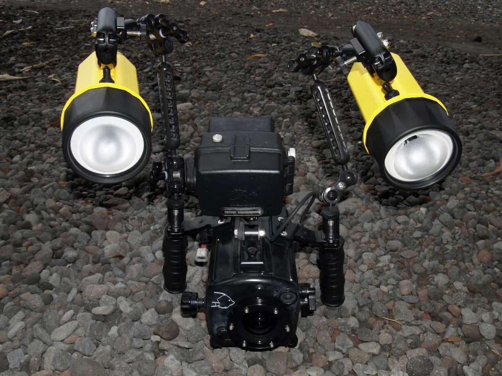

  2. I use an Amphibico monitor with an Amphibico housing. You will likely need to purchase and install the through-the-casing Amphibico connector. I like my HD monitor.

  4. You can use this monitor, however in order to stay within the Gates warranty, the housing MUST go to Gates to have the Amphibico Video Out bulkhead installed.
  5. I used one on my old Gates HC1 housing for years. Worked perfectly every dive. The conversion is easy to do, but I think the older bulkhead plug (at least the type my Gates required) seems to be getting difficult to find.
