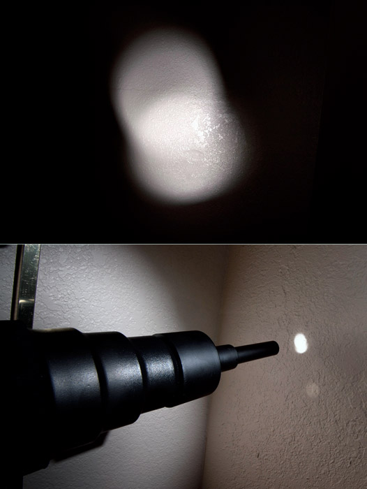

    Well with an Inon (with its two flash tubes) you get two (overlapping) spotlights with this shape of snoot on land.
    Diffuser and being underwater (more diffusion) reduces this effect (although the top shot here did have a diffuser fitted).
    IMO, using these long snoots to create macro spotlights is old technology. People want these snoots to emulate the inspirational work of Keri Wilk, but even Keri is using a fibre snoot now - as the main problem with these long snoots is their light inefficiency - meaning they can't be used in bright ambient light.
