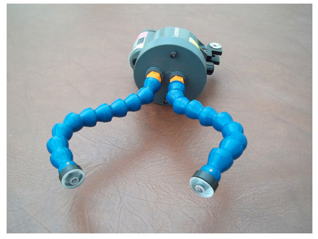

  2. Keri Wilk has some dual fiber optic snoots he has designed using loc-line arms-two snoots on one strobe. At this point they are pre production, but I am sure he would send some to you for the right price.
    Edited by gravity
  3. Keri just sent me photos of his setup. Looks nice! I'll post if he allows me to.

  5. They are everywhere!
    Here is one made by Ken Sullivan (with/for Martin Edge) that I showed at my BSoUP talk last week.
    Fibre snoots are definitely better than standard snoots for "macro spotlighting" because they are more efficient and more easily aimed and therefore can therefore even be used during the day in bright conditions.
    The downside is, when anyone sees your photos, they say "Oh, that's Keri Wilk's shot...."
    Alex
  6. The downside is, when anyone sees your photos, they say "Oh, that's Keri Wilk's shot...."
    Alex
    ;) Well he is the Snoot Master. I'll be very interested to see what design Keri comes up with.

    Hi Alex,
    Is it a snoot on the picture or the fibers end on a diffuser? I was thinking to use such a rig to make two small easy to position strobes (but diffused instead of focused light output) out of one.
    Marcell
  10. These are really coooooooool, thanks all for sharing.
    Is it possible to add some glass at the tip, so that the beam width can be adjusted, like topside zoomable strobes?
  11. These are really coooooooool, thanks all for sharing.
    An adjustable aperture mixed with a lens setup would make a perfect little unit.. then you'd have full control over the size and focus of the output. Probably a bit of overkill for a DIY setup though.
