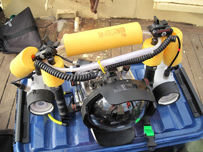

  10. My Canon 7D rig with dual strobes is 2 kg negative underwater. I have fitted polyurethane foam tubes around the strobe arms. This makes the rig floating at surface, which is good for handing the rig from boat to you safer. Once you pull the rig underwater it becomes neutrally buoyant at about 3 meters of depth. At 20 meters the foam tubes compress quite a lot, but the rig is still in pretty good balance and easy to handle. At 30 meters most the buoyancy is gone and the tubes look more like thin wrappers. I have been thinking to use something more rigid, but the basic idea seems to work. Below is a picture of the rig:

    Without the floats, the rig is really hard to handle underwater and strains my arms a lot, it is also poorly balanced. The floats make it very well balanced and easy to handle. Even when I am not taking pictures but just diving around, the floats make the rig easy to carry with during a dive. I have tethered the rig to my left shoulder D-ring with a strap, so I can just leave the rig to float in front of me during special situations, like shooting SMB to surface, helping someone (out of air for example) etc. The strap can be detached easily when needed, but it will not detach unintentionally.
    Although the rig does float on surface, I doubt it would pop towards surface once you are deep enough. Probably you could send it to surface using an SMB, in case of emergency.

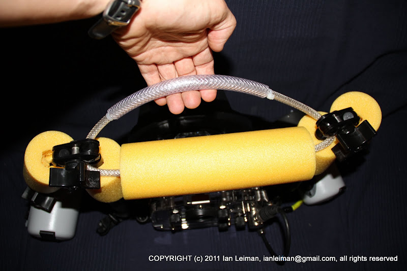

    It is a loop of heavy duty polyester cord, that has been drawn through heavy duty hose. Then I made a handle part using another thicker piece of hose, and the loop has been drawn through the float. Finally this loop made of heavy duty string, hoses and float can simply hang beteen the strobe arm elbows. Very simple construction that is easy make yourself from stuff you can buy cheaply from any hardware store. It allows you to attach the float and also acts as a handle. It is very easy take out and put back.
    Perhaps this picture helps:

    nice! I will make one myself :) thanks for sharing!
