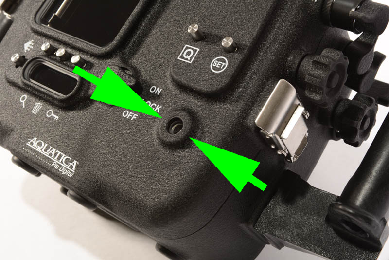

  8. Related to the new Leak detector, dont understand the position of the new led, if it is not on the top view, (the top view faces the batt), how can I see that led, in the bottom view, with a closed housing?
  9. See that dimple to the right of the LCD? That's a recess in the window of the housing where you insert the LED into. That's how it comes from the factory. LED is easily visible when you close the housing. Same goes for installing the new Surveyor vacuum board.
