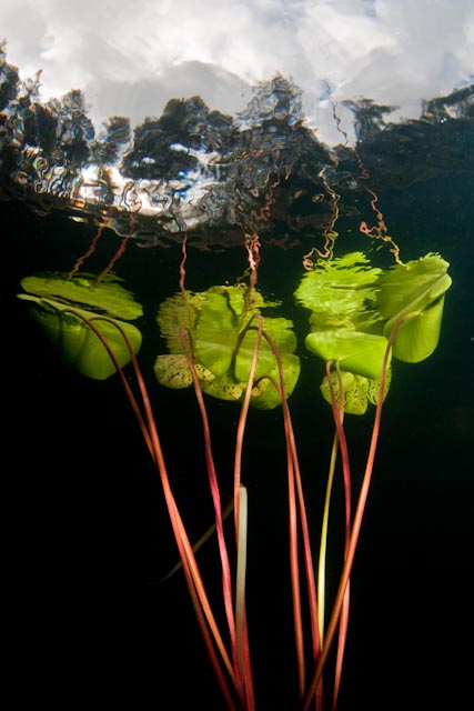

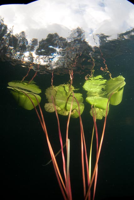

    Udo mentioned that Hugyfot Wide Angle Port - L 50 / D 128 is only suitable for rectilinear WA's and standardlenses.
    I have tested Hugyfot Wide Angle port with Tokina 10-17 and Canon 400D. The picture was taken as wide as possible (10mm) and the result can be seen in picture IMG_1.jpg.
    Picture IMG_2.jpg is after cropping the port shade.
    I have no understanding about nodal points but to me this seems to work as long as I leave enough space for post cropping or zoom in just a little bit.
    Am I right or wrong? Or is there something more I should have thought?
  7. Udo mentioned that Hugyfot Wide Angle Port - L 50 / D 128 is only suitable for rectilinear WA's and standardlenses.
    This is one of the reasons i do not want to use this dome with the fisheye: i prefer not to crop. On top of that, Nikon DX has a slightly wider angle than canon APS-C so i would even have to crop more. BTW, i tried it also with my own Hugyfot standards dome, and to me the cornersharpness in that configuration was unaceptable. And also the angle was less then with the big Hugydome, because the standard WA dome from Hugy is more flat (or less curved).
