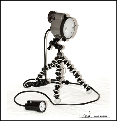

  2. Hey Andy
    I've recently used a Gorilla Pod with a ball mount and wired slave sensor. The Gorilla Pod wraps around the Tank valve pretty securely and the strobe head can be positioned werever you want it.
    Hope this is of use
    Nige Wade
  3. Hey Andy
    Hope this is of use
    Nige Wade
    Too funny! That's my setup only with an Ike strobe. I hadn't thought of mounting to the valve. Is it visible in the photos? Thanks!
  4. Too funny! That's my setup only with an Ike strobe. I hadn't thought of mounting to the valve. Is it visible in the photos? Thanks!
    The beauty of the "Pod" is that it can be squeezed quite small around the valve pillar and the strobe head can be positioned so it can't be seen, it holds it all nice and tight.
    Although I haven't tried to light a cave / canyon / reef wall from this position, rendering the diver as a sillouette and as the source of light would look awesome.
    I've only had the chance to briefly experiment with the set-up and have concentrated on backlit profiles.
    Good luck with your "Project" Andy and lets see the results
    Nige Wade
