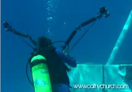

    At 3:24 in this clip
    , you'll see Cathy Church handling her Subal rig through the bridge window just holding onto one strobe. I think she is using 2 x 12" arms.

  5. At 3:24 in this clip
    Indeed those do look like 2x12" ULCS thick arms:
    It doesn't look too bad, and as can be seen from the video, arms like these do provide a lot of flexibility.
    The sync cords do look seriously stretched, and I would be a little concerned about the strain to connectors, but maybe I'm just being too cautious.
    I tested myself, and it seems that the Ikelite #4103.52 dual coiled cord does stretch over 1 meter to each side, so even using dual 2 x 16" arms should be possible without extension cords - provided the strain doesn't cause an issue.
