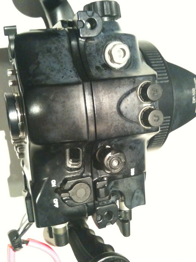

    sorry one more thing, the housing has a white oxidized look can you polish it up with anything to make it look new? or am I better off leaving it alone? thanks

    I have no idea what to tell you about the discoloration. I've heard it mentioned here by folks but my housing hasn't done that yet. Hopefully a Nauticam dealer can jump in and help us out.
    Hi Scubajunkie,
    Congrats on the purchase!
    That white look is just minerals finding the microscopic pores in the anodizing. With a a quick wipedown you can get rid of it and make the housing look new. Reef Photo can get you a magic liquid to do this - you might give them a call. I don't have the name of it handy, but it was the easiest thing I've used to polish up a housing. I've used plain silicone grease with good success, and it not only removed the white stuff but kept it off. Furniture polish ala Pledge is supposed to work too.
