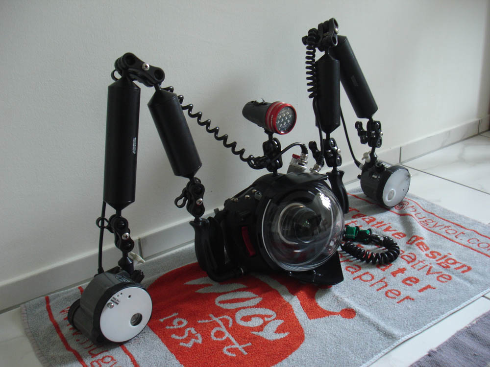

  2. I've got the 550D for one week. Didn't test it in the water, but it looks well and high quality. Hugycheck system is included and I like a pressure rating to 100 meters also. Single hand control looks nice and you have full acces to the camera buttons.
    The small problem is with their strobe arms, which have a 24mm diameter, but the balls on the housing are 25mm.

  8. I've had top reliability so far after two years (enough time to wear out the tubes in two Z240 strobes) and Hugy have even made me an adapter so I can use my Sea & Sea optical dome port with my 15mm lens on a D700.

    The Hugychek leak warner seems to work fine and the allen wrench bolts closure system avoid accidental snap-opens.
    The camera mountig plate is not very ergonomic, but Hugyfot is working on a new model of this plate.
    The Hugyfot don't have a port locking system and the bayonet mount locks in place with about 1/8 turn of the port.
    I put some white color on the alignment marks to see from "far" if the port is in the right position.

  10. The Hugyfot don't have a port locking system and the bayonet mount locks in place with about 1/8 turn of the port.
    Chris
    Chris,
    When the housing is depressurised with the Hugycheck, the port is effectively locked. I challenge anyone to remove it! Ambient air pressure and water pressure does the job.
