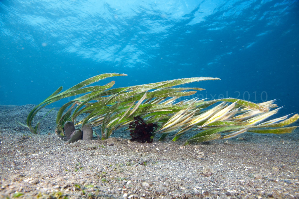

  5. As Jean sez, the 24-105mm can be used with a +2 or +3 diopter, with the 8" and 9.25" domes.
    Here is a sample of the lens @ 24mm. In this example, I was using a +3 diopter and a 60mm extension with a 8" Zen dome. 60mm is 0.5mm too long for the Zen dome port with this lens. There is VERY slight vignetting @ the top. It's really negligible!
