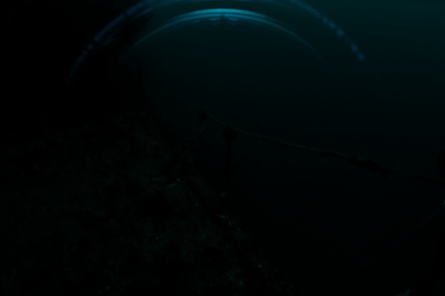

  1. G'day All
    Wondering if anyone else is using this combination and if you have a fix, first time I have had the new glass underwater, thinking I am going to have to build in a baffle of some sort.
    Nauticam D300s
    Zen 9" Glass
    Tokina 10-17 fisheye
    And the result....
  2. I have the same with Tokina + Hugyfot Dome. Just made a foam rubber ring, which I put on the lens and reflections are gone.

  4. Thanks Gudge,
    Thats nice and just what I was looking for.
    Looks like an issue with the larger Zen 9", I don't have any reflection with my smaller ones either.
    Pete at ScubaPix just Emailed me as well, he says Nauticam actually make a buffer for just this occasion.
    And just a thumbs up for tops service as well, Pete is in Lembeh on holiday and I had an Email within 30mins of posting :)
    http://www.scubapix.com/
    Thanks All !!

    Hey Chriso,
    Just grab the foam cozy from your Murrays Wild Thing and cut a section to go arround the Tok. Light loves negative space.
    Bob
  7. You need Nauticam #28109. It is a rubber ring that mounts between the plastic port bayonet ring and aluminum port body, or the same parts on an extension if used, and completely blocks out light leak.
  8. Here is the rubber ring, installed in the groove on an extension ring. This can also be pressed into a dome or flat port, but it needs to be attached the the first accessory part locked directly to the housing.
    The easiest way to illustrate this was to turn an led flashlight on behind the housing, shining through the lcd window on the back. Light from the internal flash wouldn't likely shine through in this location, but this shows that the gear alone won't block all of the light.
    And here is an image with the rubber ring installed:
