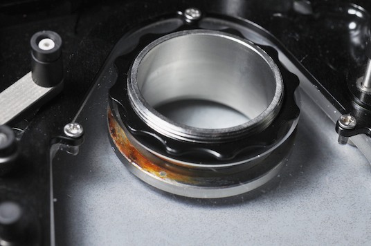

  1. I have noticed "rust" forming on the inside edge of the eyepiece housing on my Nauticam Ad-90. I usually let the housing soak in luke warm water for about 2-3 hours after every dive, but that hasn't seemed to prevent corrosion forming here. I'm finding it very hard to accept corrosion on my pride and joy, and want it gone........now!
    I can't get to the corrosion unless I remove the eyepiece housing, but I'm not sure about doing that.
    Anyone else with the same problem or solution?

  5. Hi All,
    Despite specifying high grade stainless steel when ordering material from vendors, Nauticam did see some parts shipped that had surface tarnishing or rust indicating a lower grade material was actually received. Once the issue was known, Nauticam started testing every stainless steel delivery when received to verify that the correct material was delivered. This extra quality control step has effectively eliminated this problem in new models, and I'm sure your local dealer will be happy to replace the part under warranty.

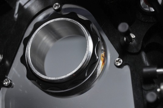

    The rust should be easy one to remove. When I see something like this, I test it with
    small magnet as good grade stainless steel will not stick to the magnet.
    Sam
  8. Sam, it is not exactly accurate that all T316 is austenitic. If I remember correctly, it is the materials like Chromium (Cr) and Mo (I use the symbols cause I can't remember how to spell it! :)) that give stainless steel their resistance to corrosion, and Ni and Mn to lower ferritic properties. When stainless steel is cold worked, it can transform to be ferrite, by transformation of martensites (sp?). Thus while the magnet test is a test lots of people use to sort 300 series steel, it can be wrong.
    That said, it seems that Nauticam had QC issues with the quality of their stainless steel parts. The magnet test, while possibly inaccurate, is a good test, since the alternatives like spark and acid aren't exactly going to work! :B):
    In fact, recently I did such a test on the Nauticam D7000 housing and found several parts to be ferritic, including the locking mechanism. I subjected the magnet test to the Seacam and Subal D7000 housing and all points were austenitic. Now as I said, the magnet test doesn't necessarily mean anything on its own, but with CP's statement about the lower grade steel being used, it could mean something and owners would do well to check their housings more vigilantly, especially those with housings that are older as this problem would probably manifest later in the the life cycle.

  15. I own the Nauticam D7000 housing, and I too have noticed a ring of rust around the viewfinder. If this is a problem that only pertains to early Nauticam models and was addressed and fixed, then my D7000 must have slipped through the cracks. I'm happy to hear that it should be able to be fixed free-of-charge, but there definitely appears to be a quality control issue.
  16. wrayphoto, I'm guessing you have a different issue. If you pop the viewfinder out you'll probably see that the rust is localized around the spring pins that prevent rotation. Some of these pins have been rusting in recent models, and will also be replaced free of charge. Email innovation at nauticamusa.com, and Chris will get some parts down to you.

  18. After further investigation, it does appear that the rust issue I've experienced is due to the spring pins in place to prevent rotation. Everyone at Nauticam has been very prompt to respond to my inquiries and help resolve the issue as soon as possible.
