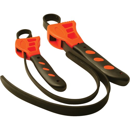

  2. ... I can not get them apart...
    A pair of rubber strap wrenches should work:
    I carry a medium-sized one in my dive bag.
    Tim

  4. +1 for rubber strap wrenches. I had the same problem with my Ikelite 8" dome port and extension ring, and the wrenches did the trick. Don't leave it screwed in for too long after diving or it may get stuck.
  5. +2 for rubber strap wrenches. I had the same problem......:-)
  6. Hi guys
    i have now tried 2x strap wrenches and heating the rings then strap wrenches but still no joy. I heated them in boiling water would it be worth trying to heat them above 100oC in an oven and if so how high would you go?
    the rings are lugged so there is no chance of cross threading.
    they have now been stuck for 6 months and two dive trips.
    Roddy
