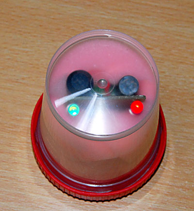

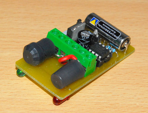

  3. I want to build a motion sensor that triggers the camera underwater. ;)
    Just received the PIR sensors and will try them soon underwater.
    Will post the results.

  5. I want to build a motion sensor that triggers the camera underwater. :huh:
    As expect they don't work underwater :D
