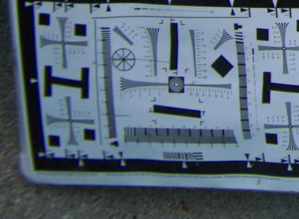

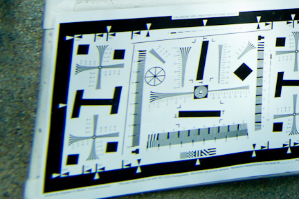

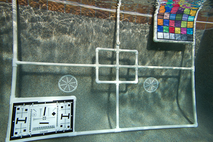

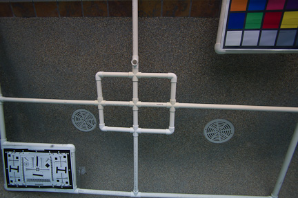

  8. Did a little test with the diopter on the 10-22 and I have to say I don't see a big difference in the corners. First one is with the S&S NX Fisheye dome, 10-22mm on the Nauticam 7D housing.
    ISO 320, f/8, 1/60th, Second one is same set up with the addition of the B&W +2; ISO 160, f/8, 1/60th
    Here is a roughly 1:1 crop of the bottom left corner, no diopter, then with the +2
    The pincushion distortion you describe is very apparent. The angle that I took the shot probably makes it look worse.
    Sorry for the different exposures, it's monsoon season here in the desert and I was ducking in the pool between thunderstorms.
    I think I'm leaving the Tokina on. Remember folks, you'll likely get different results with a different dome.
