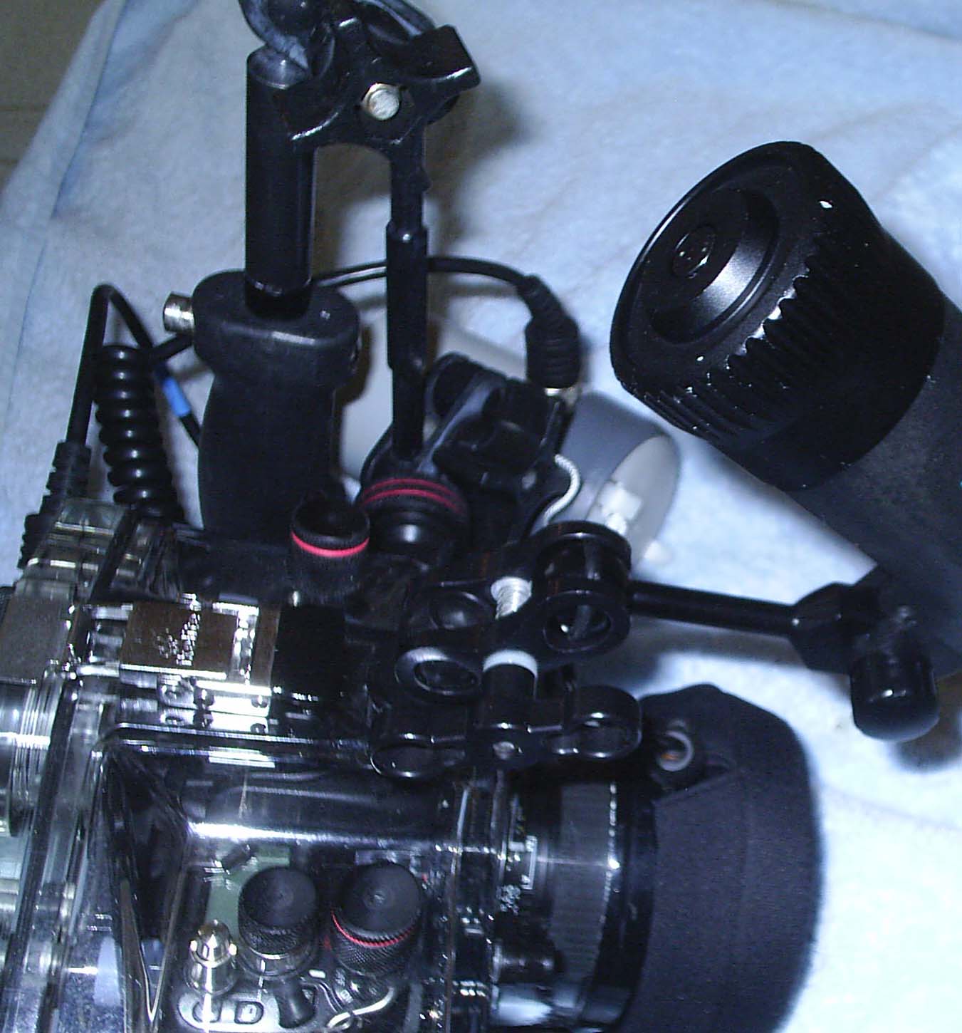

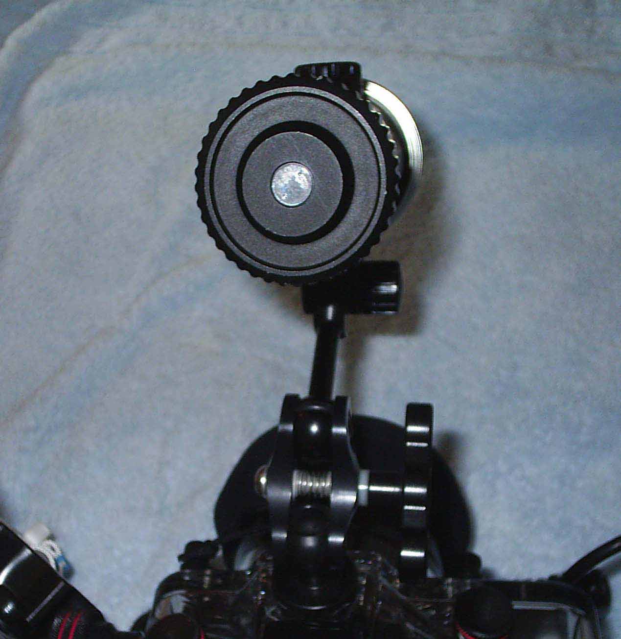

  1. Suggestions are welcome
  2. Fisheye Fix LED500, YS ball adapter and ULCS clamp.
  3. If you just want a focus light, in clearish water, the fisheye mini led cannot be beat, at $49!
    http://reefphoto.com/index.php?main_page=p...68385ca7abf2f95
    It could use the same clamp and 1 short arm segment as John showed above.

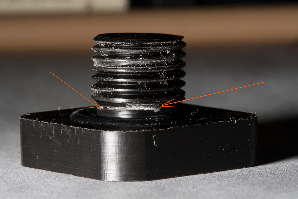

  4. don't!!!!
    I put a ball on mine and took it for a dive and it flooded through this mount, luckily camera and all saved. Would hate to think what would have happened if the focus light was on it. To give Ikelite their due, they had a replacement part straight in the post. They said it is re-designed but will see when I pick it up in uk in a couple of days.
