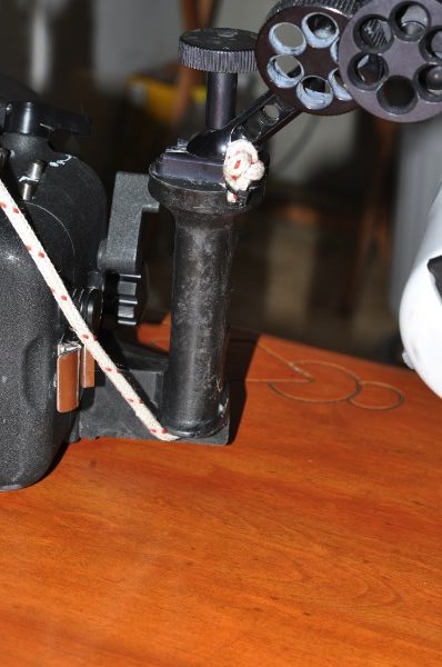

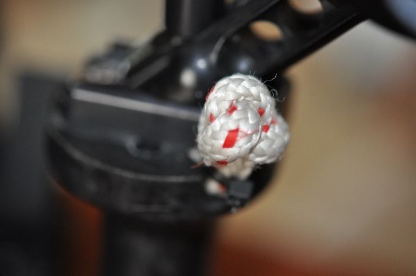

    On my Aquatica system, I run a 3/16" line up through the hollow grip on the right side. The strobe arm system mounts to the top of this, but conveniently, there is a little notch in the grip. I run the line out through this and knot it. The other end has a bolt snap which I clip to a D-ring on my right-side BC or backplate harness. The line is about 30" long and non-floating line. Works like a charm.

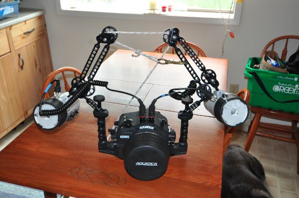

    One unexpected bonus of this, is that I can use it to "wrap up" my system. My Aquatica arms won't support the strobes out of the water, so I wrap the line around the "elbow" in the arms and clip the snap onto the opposite arm. I can actually carry the entire system by one of the strobe arms (although I don't tend to).
    I dive from a RIB up here, so I also use the line to lower the rig over the side before I roll in, and then pick it up once I'm in the water...

    Originally, I considered drilling a hole through the horizontal portion of the grip, but the bolt that attaches the grip runs through there. On the Aqautica grips, the grip itself is already hollow so it was a bit of a no-brainer once I figured out how to fasten it. The knot isn't pretty, but like you, I'm not crazy about sending my system to the bottom of the deep blue!
    I've added some photos for you as well..
