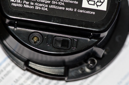

  1. Simple one this, I am currently trying to breathe life into an old pair of strobes, so I can have a pair of wide angle strobes permanently at home (meaning I don't have to bring heavy wide angle strobes on low-cost European flights).
    I am running a pair of old Nikonos strobe, an SB102 and SB104:
    The SB102 is working great - but I was disappointed with the charge on the SB104. Before I cut up the battery pack - as indicated on this great thread here, I would like to check I am charging it correctly (I don't have a manual).
    What is this switch on the battery pack for - and which way should it be switched for charging and shooting?
    Many thanks,
    Alex
  2. If I remember correctly it is just a reminder switch and does not actually do anything.
  3. Yes, as Tom already noted, this is a dumb switch, serving only as a reminder for whether the pack is charged or not. I personally never use it ! :)
