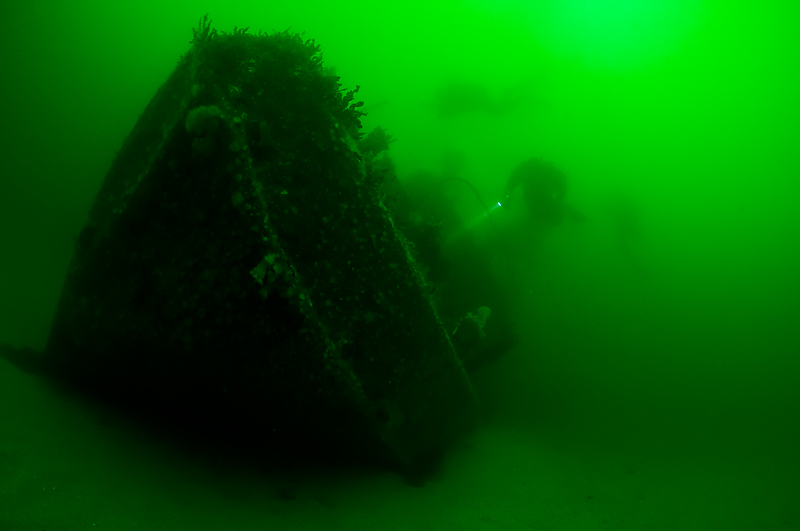

  2. The most important factor for success is the ambient light level. As unlike a strobe both (ambient light and torch) are effected by shutter speed AND aperture. In bright conditions (Red Sea wreck exterior) continuous light can fail to compete with sun. But in dark, murky UK conditions it can be great way of shooting and faster and easier to use than off camera strobes.
    Here is a shot with a single Sola 600 inside the Gok Wan wreck (in awful viz) in Shetland:
    Alex

  4. From what I remember the SOLA was on its lowest power setting - but then it was very dark!
    Alex
