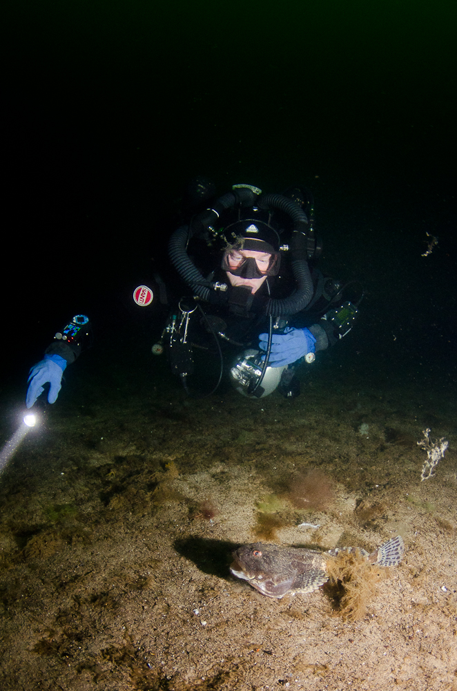

    I am totally new in terms of TTL/Manual via fiber optics, the thing is that I think one of the lightning strikes less than the other, have the same settings on both.
    If you look at the shadow, it is sharply to the right and it is so in all images (both via TTL and Manual)
    Does anyone have any tips on good settings for the camera and flash, Macro and wide angle

  2. I guess that you have the right-side strobe nearer to the subject than the left. You may also have the left-side strobe aimed behind the right. Your buddy is too well lit for both strobes to have been aimed at the fish.
    I try to have symmetrically positioned strobes then dial down the power on one by 1-1.5 stops. I've noticed my strobe arms creeping into other positions after a while, particularly if I keep adjusting them from shot to shot.
    Tim

  3. Hi
    Should like to add: even if I have the right strobe further back so it is stronger than the left one.., if I switch side of the strobes, than the left is stronger so one of the strobes are much more stronger :B):
  4. Anders, you might have a strobe that is not adjusted properly or worse, that is defective, do you have access to a flash meter? it would be worth taking a reading off each strobe to compare.

    I'm afraid that Jean is right in this matter, my suspicion is verified, unfortunately, I have no light meter, but how do I check the strobe in this case??
    I think I've got water into the electric contect a while ago, could that have any affect?? I mean that the electric contact is shielded with silicone or rubber??
    /Anders
  8. I'm afraid that Jean is right in this matter, my suspicion is verified, unfortunately, I have no light meter, but how do I check the strobe in this case??
    /Anders
    Swap the left and right over. Keep everything else the same. See if the effect reverses.
  9. The Z-240 and the D7000 work well together being optically triggered.
    You may also had:
    - different settings of the power dial or exposure mode
    - 1 flash had the 1/4 EV compensation switch on while the other not
    Do some tests in the night on land (or in a pool) to verify the power output of both strobes.
    You can put a white sheet about 10/20/30 ft away and take pictures in the night, this will show
    you the power output without a strobe meter.
    Chris
    Edited by ChrigelKarrer
  10. Anders, if you do not have a light meter, then I would suggest setting up in a room, put a middle tone subject about 1.5 meter away with the background at about 2 meters, to check TTL (& S-TTL) take one strobe at a time and take pictures at 1 stop interval, the exposure should remain fairly constant (do give the strobe time to recycle properly), swap to the other strobe and do the test, at this point, if both strobe are in good shape, then result should be faily similar (might want to comape histograms), if one strobe is defective (or wrongly set up) then exposure will be all over the place. for good measure, if you have a Nikon flash, do the test with it as well so you have a reference set of images, Nikon's TTL is notoriously precise.
    Just an idea I had, there is a magnet switch on the Z240 that manages the pre flash, are they both on the same position?
