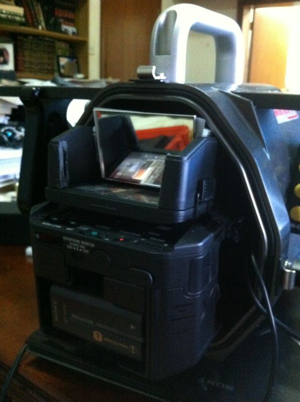

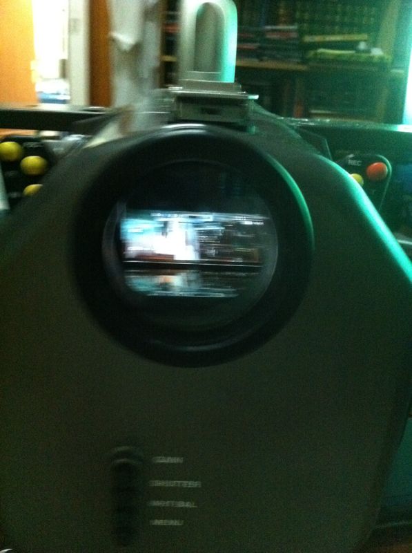

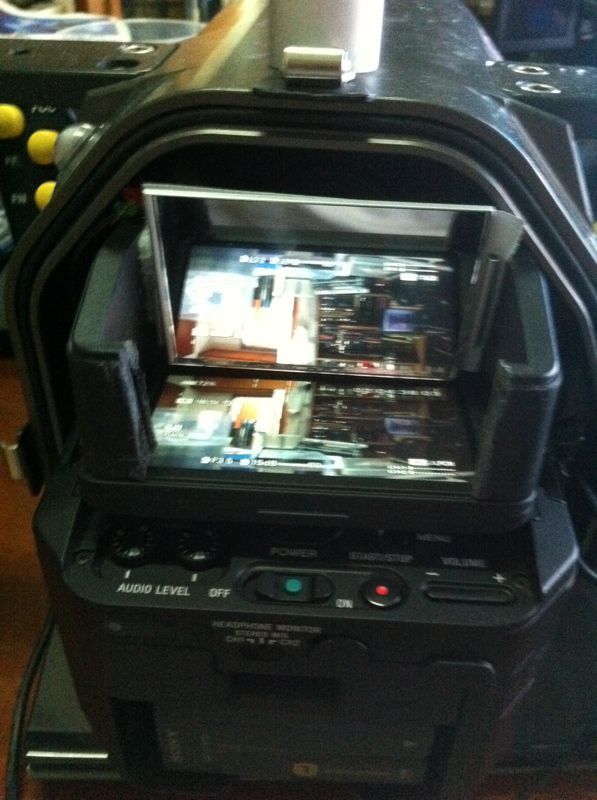

  13. Hi there,To continue the modified housing project and to fix the view finder issue, my friend used a mirror to reflect the Camera LCD. He raised the LCD a bit to flip/reverse the image and he installed a mirror as seen in the below pictures: (I preview the post and the pics appear. Plz help me if they do not apper: How to post pics?)
    Edited by thani
  14. Hi there,To continue the modified housing project and to fix the view finder issue, my friend used a mirror to reflect the Camera LCD. He raised the LCD a bit to flip/reverse the image and he installed a mirror as seen in the below pictures: (I preview the post and the pics appear. Plz help me if they do not apper: How to post pics?)
    I used cut & paste on my ipad2 before and now I used the attachment Editor which works fine but not so intuitive.
  15. Very cool, Thani. Just be careful about sunlight if that viewfinder is magnified. It can act like a small laser and fry things.
  16. Looks like a tight fit in there but well done. :)
  17. Very cool, Thani. Just be careful about sunlight if that viewfinder is magnified. It can act like a small laser and fry things.
    Your assumption could be true, especially with our burning sunlight in this part of earth shining 365 days and.
    Thanks guys and will keep you posted.
