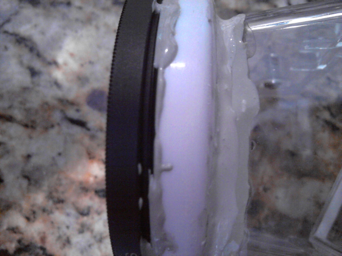

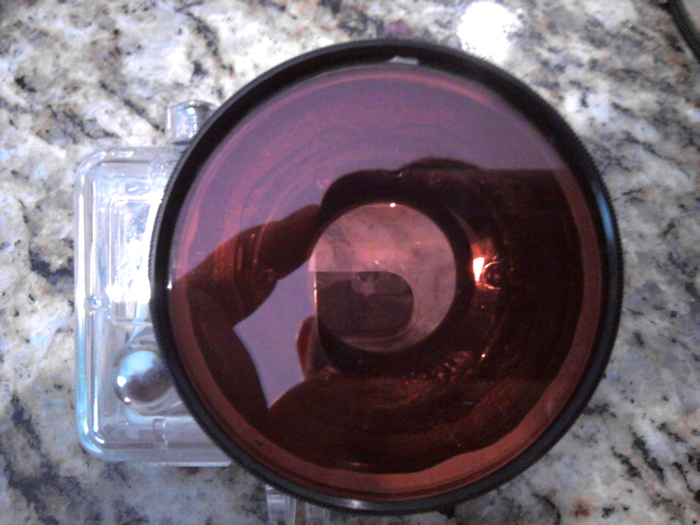

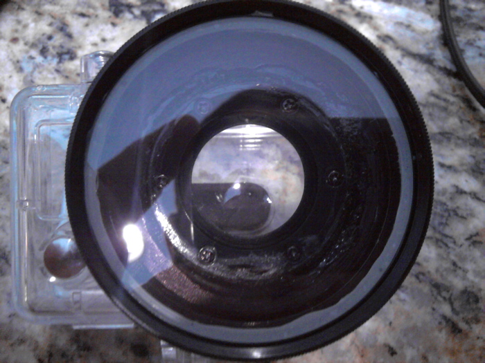

    Thanks, the main reason why I went with the FLB instead of the 85 is because I was able to find the FLB for cheap on Amazon. Also, I do have to get closer to my subjects because the GoPro's wide angle lens makes everything seem so far away. I'm going to post some pics of what the setup looks like in case anyone else wants to do this with a GoPro.
  13. Here's with and without the red filter, as well as my version having the glass stay inside the filter ring instead of stacking the ring on top of the glass.
