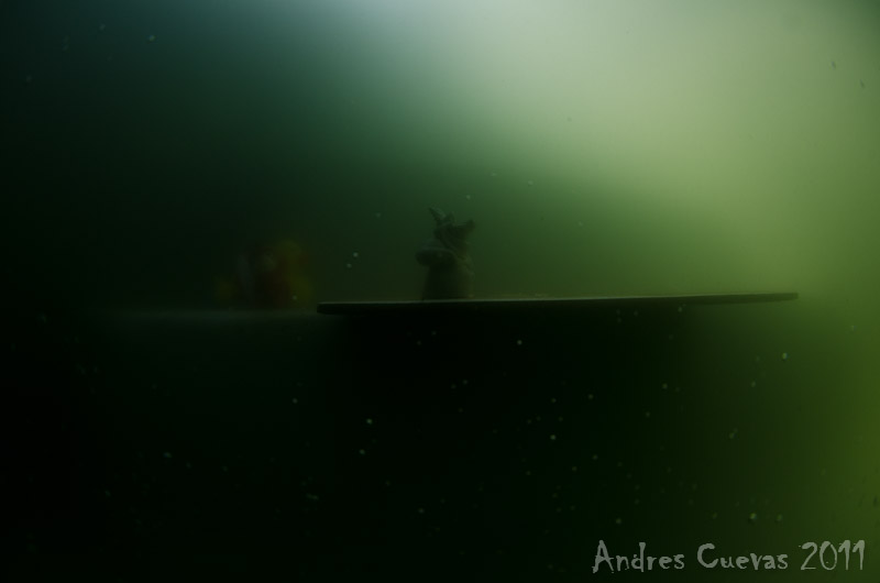

    I took some shots without the strobes in order to adjust aperture and shutter speed.
    This was really easier than with my P&S camera, I don't have to press more than one button to deactivate the strobes and I can review the shot very fast.

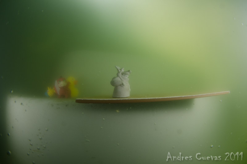

    Now I realize about the bubbles in the dome, I need to be more careful about it next time.
    Before approaching the subjects, I adjusted the strobes taking a few more shots. Again easier than with the P&S.

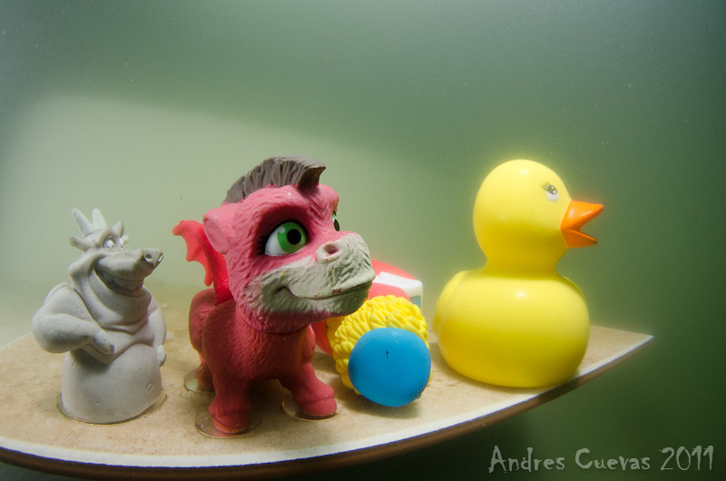

    Then the fun begins. Using some small toys I started to take some CFWA shots.

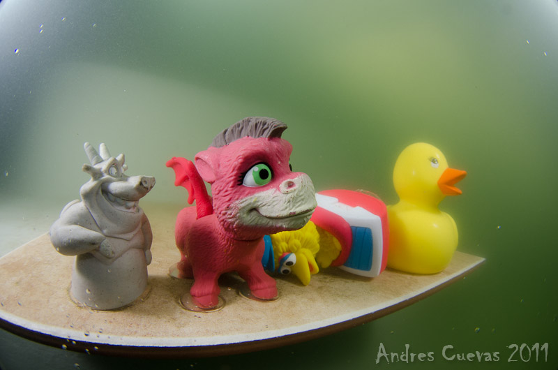

    Two problems I faced:
    Dark area in the middle and the strobes too near to the limits of the frame shot:
    After an hour and forty minutes in the water I realized the following.
    Pointing the strobes a few degrees to the inside resolved the problem of the dark area:

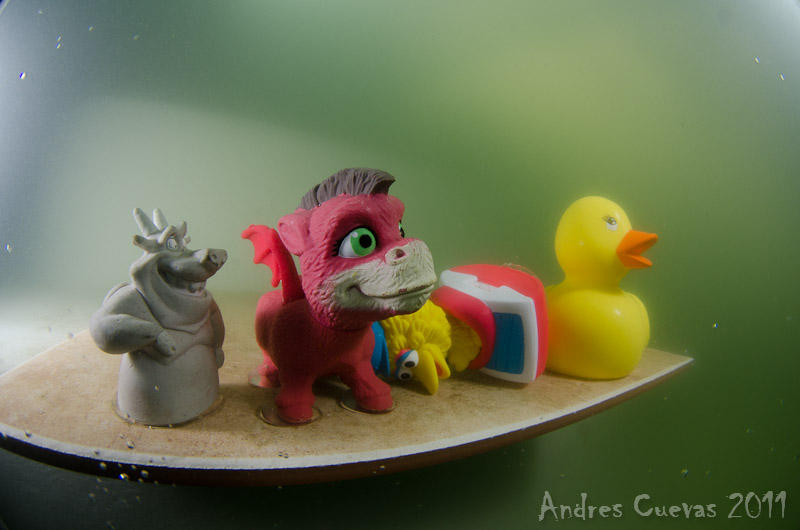

    Moving the strobes back resolved the problem of too much light in the corners:
    In the last shot I aimed the left strobe in the left side of the frame very near to the housing, the right strobe was above the housing. I think that the right strobe could be moved a little back, I didn't noticed underwater.
    Any comments about strobes techniques for CFWA will be very much appreciated.
    This is the first time I take a shot so close to the subject, being careful not to scratch the dome.
    I wasn't expecting so clear images with the conditions of the pool, I cannot wait to see the results in open water environments.
    In brief, this is getting fun and I'm anxious to go to dive and take some shots.
