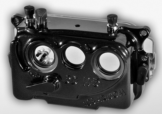

    I have heard good things about the Fuji W3 when it came out. There is even a housing made for this camera. See photo attached.
    It is not as much fun as making your own and the Raynox lens will not fit this housing. I would be very interested in the results with your custom housing. I am also planning to fit two matching wide angle converters to the TD10. Sony uses G lenses on this camcorder so I need to get the best possible wide glass for this. If this works then in theory putting two close-up lenses might allow focus closer? That would be awesome if it works.

    Fuji W3 would be one way for just wanting to learn about 3D video. You will soon out grow it.

    I know about the housing for the W3, but as you mentioned, not for wideangle use, which imho makes it useless for underwaterphoto/videography..... at least in the scandinavian waters with low viz and light. With a price over 1000 US$ (http://www.fantasea.com/s.nl/it.A/id.497/.f) I found it to be far too expensive as well... specially if I compare it to prices on other housings for the pocket-cams.
    When I'm not working on my costum build W3 housing, I try to find some information to help me figure out what kind of light to go for. As an absolute beginner I simply have to belive what I'm reading and so far I discovered both advantages and disadvantages on HID and LED.
