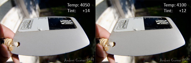

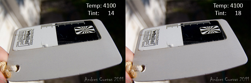

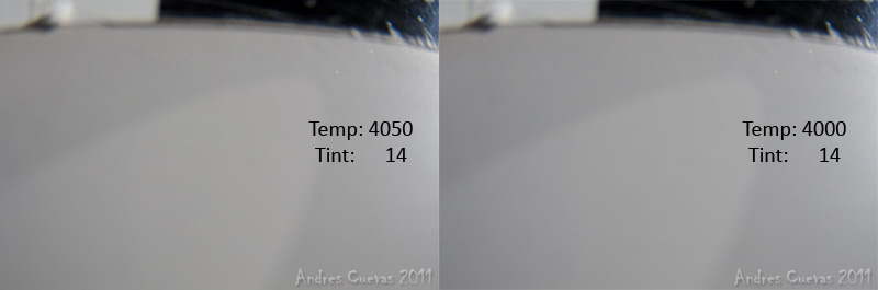

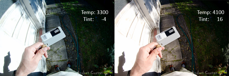

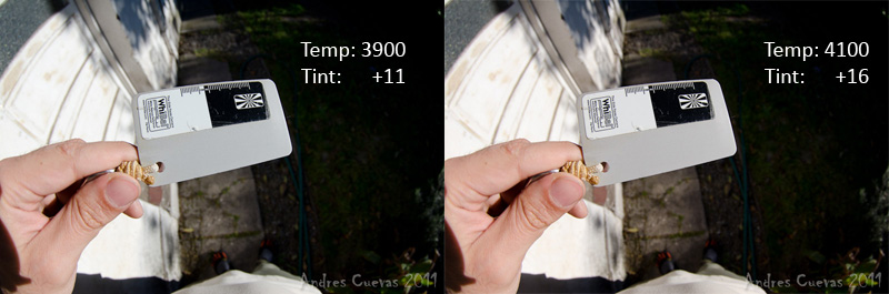

  9. I got new result from my testing with the pocket size whibal and the nikon D7000 and Tokina 10-17
    This are the test I made:
    Left manual white balance in camera - right white balance in Lightroom
    At 10mm
    At 17mm
    I think that the best result were at 17 mm end.
    But in conclusion, it is possible to use the whibal to make manual white balance.
    Behind a dome might be better to use something bigger than the pocket size card.
