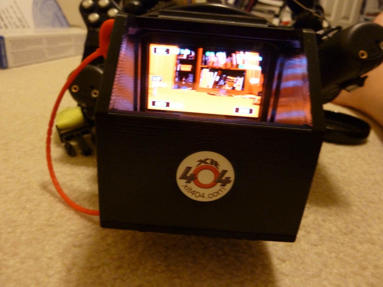

    Here's a few of my unit: Looking at the detached unit with its leash (supplied):post-18574-1323738206.jpg

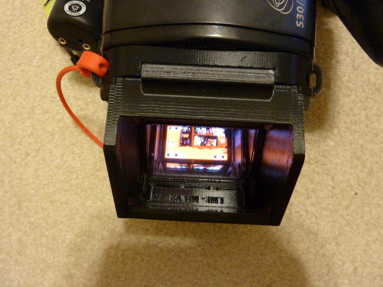

    Looking down on the unit:

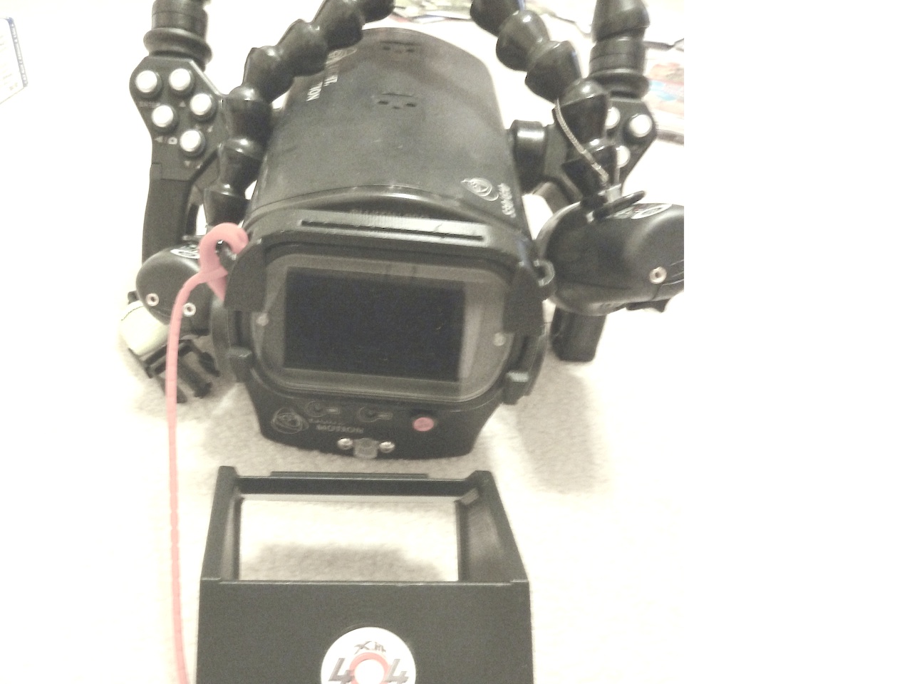

    Looking from the rear:
    The view looking downward and the view looking from the rear are nearly identical in size, my awful photos notwithstanding.
