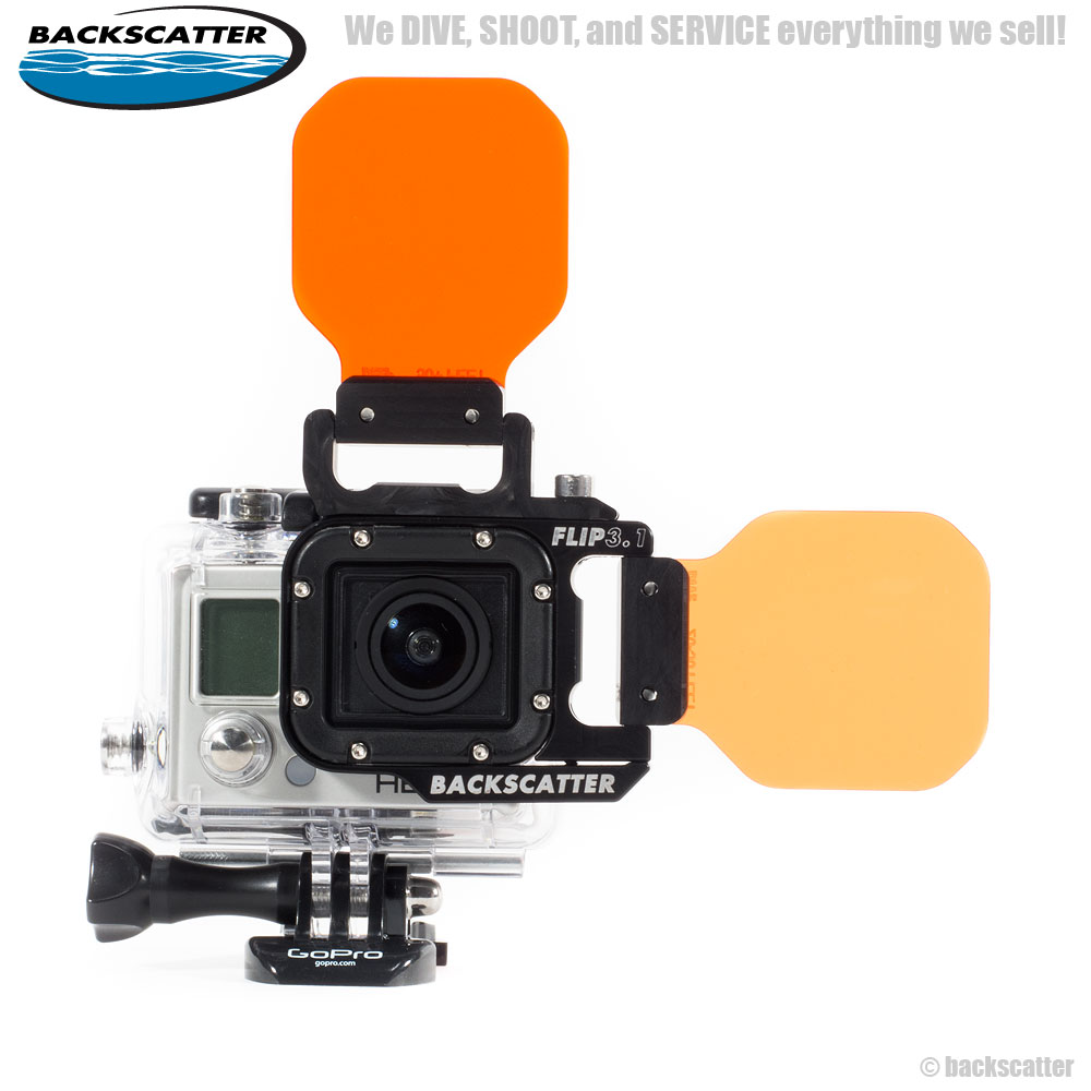

  11. There are better options than gels, now. The flip type filters allow you to use a filter...or not. If you go shallow, you will not want a filter. Deeper? Yes. Backscatter offers a decent one.
    I have the flip red filter with the Macromate mini macro lens. I love the flip red filter.....not so happy with the macro lens.

  12. Hi Allison,
    I'm not sure which image you are thinking of. I saw the Backscatter flip filters at DEMA and they look very good. Here is a picture from their website;
    They have different options depending on depth, green water, etc. even one for flouorescence.
    http://www.backscatter.com/sku/bs-flip31-combo.lasso
