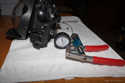

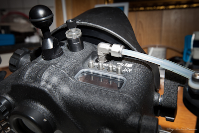

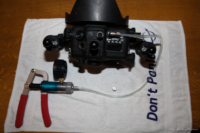

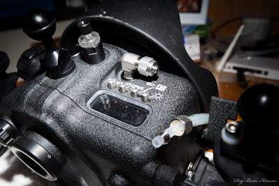

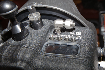

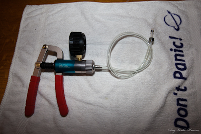

  1. Then I finished my new project. Made my self a leak tester for my Aquatica UVhousing.

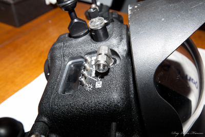

  2. Looks great, does the swagelok fitting have a stand NPT thread or did you have to use an adapter?
  3. Looks great, does the swagelok fitting have a stand NPT thread or did you have to use an adapter?
    It have an orginal NPT thread on it.
  4. Now I just have to figure out what thread my Subal has. It has an unused bulkhead, sure would be nice to know it won't leak before I dunk it.

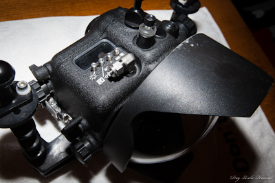

    How much vacuum do you pull when testing it? and do you plan to leave it at vacuum when diving?
    Thanks!
  5. Now I just have to figure out what thread my Subal has. It has an unused bulkhead, sure would be nice to know it won't leak before I dunk it.
    Thanks!
    I can get it up to -0,5 bar(-7,5 Psi). Then I leave it about 10-20 min to see if it drops. If you leave about -0,1 bar then you can't get it apart, nice to have when you put the rig through the splash zone.
