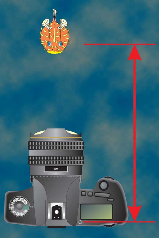

    The other big plus of the Tokina is the minimum focusing distance, it is really close at 14cm, and remember that this is from the film (sensor) plane See drawing), so that is very close to the front of the lens or should we say, dome surface. if you do however decide to go with the Tokina 10-17mm, I would recomend the 6" dome port so you can take advantage of the minimum focus distance.
