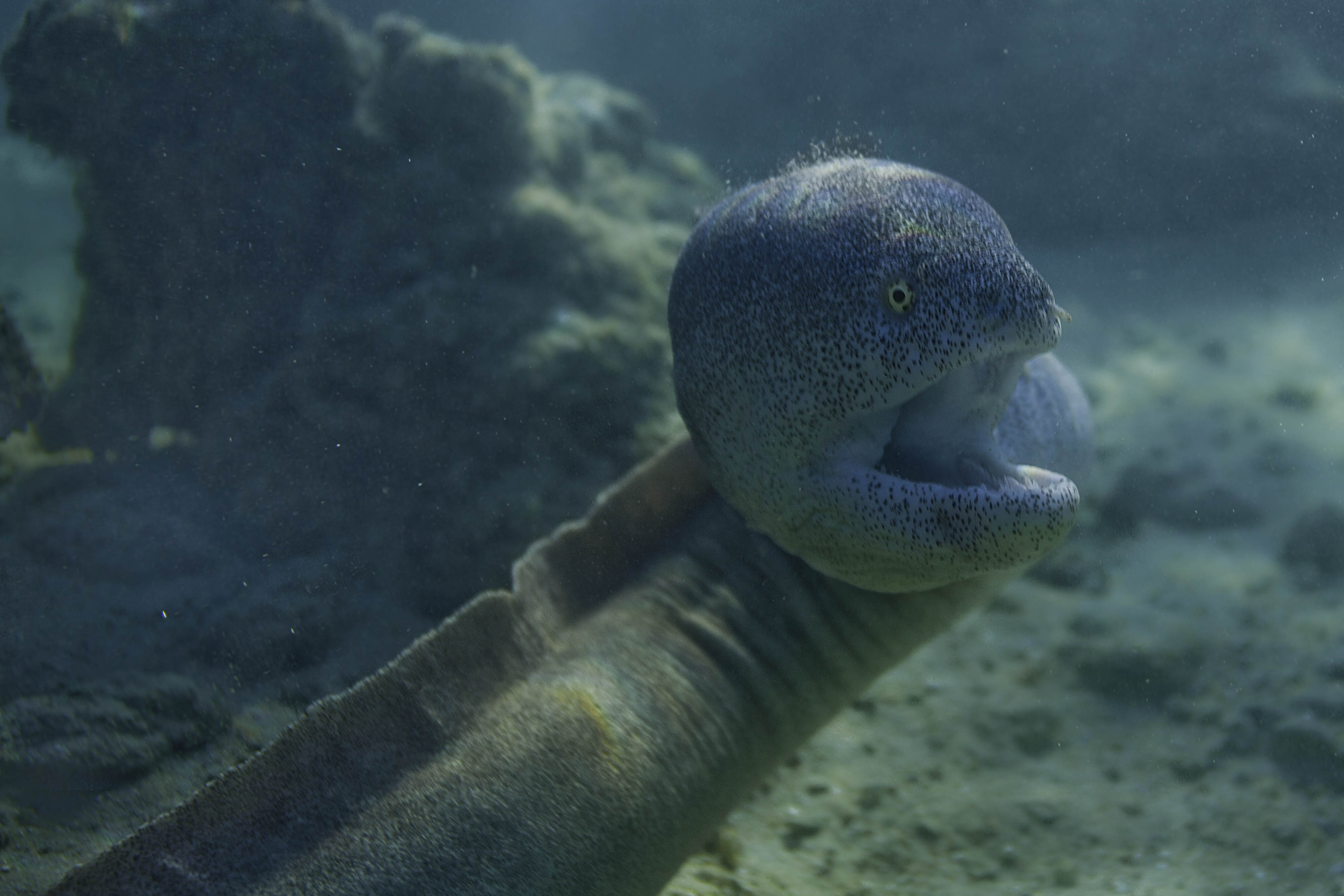

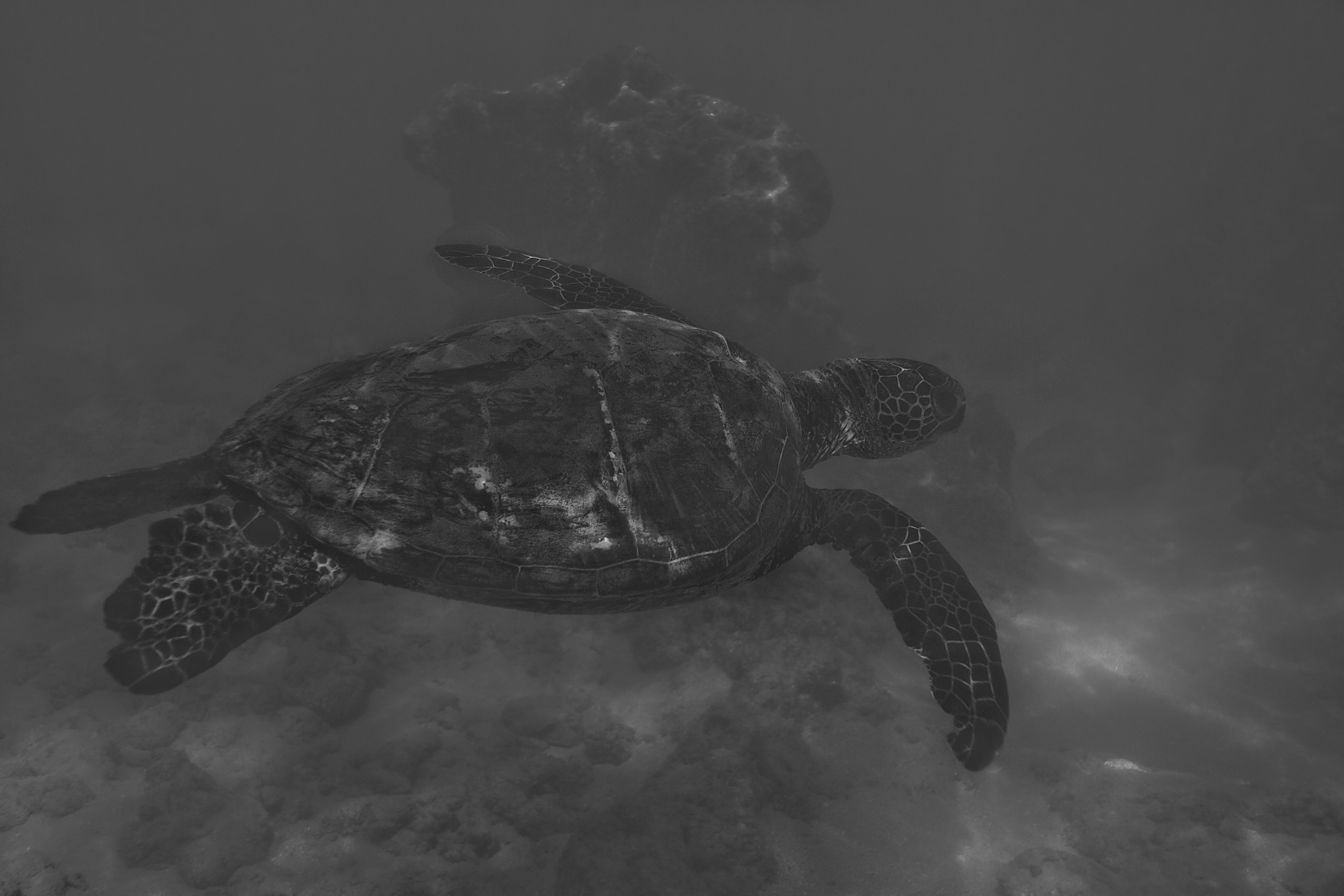

  1. So as per the suggestions on this board, I bought an ikelite 5d housing for my canon 5d mark ii. I am using a 17-40L lens with the 8 inch dome port. My photos are not coming out blurry but they are nowhere near as sharp as I am accustomed to. I shoot mostly studio and landscapes so am I just being too picky? Is the water always going to cause my photos to be a little less sharp? I will try and post an example. I have only gone diving with my camera twice and feel like it is the first time I have ever used a camera so please any advice would be much appreciated.
  2. So as per the suggestions on this board, I bought an ikelite 5d housing for my canon 5d mark ii. I am using a 17-40L lens with the 8 inch dome port. My photos are not coming out blurry but they are nowhere near as sharp as I am accustomed to. I shoot mostly studio and landscapes so am I just being too picky? Is the water always going to cause my photos to be a little less sharp? I will try and post an example. I have only gone diving with my camera twice and feel like it is the first time I have ever used a camera so please any advice would be much appreciated.
  3. This is probably a better example. The focus was on the eels jaw and it still looks out of focus.
  4. This is probably a better example. The focus was on the eels jaw and it still looks out of focus.
    I forgot to mention that these were taken with ambient light, F10, ISO100, 1/200s
  5. I forgot to mention that these were taken with ambient light, F10, ISO100, 1/200s
    Hi Team2jnd
    I use a similar setup, but I have only dived it maybe 15~20 times or so.....is this your first time using a DSLR underwater?
    I use the Canon 16~35mm lens on my setup
    The EXIF data for your shots says the aperture is f5.6 ....could you have been shooting in Tv (Shutter priority) Mode?
    Also the eel...there's a good chance the critter (or you) moved between focus and capture and at f5.6 (as you know) there's little or no tolerance for that.
    In available light you could do with using a higher ISO setting and since the sensor on the 5D is flippin awesome, wind it up to 400 or even 800 to get a better aperture..I have 3 "Standard" setting programmed onto C1..C2..C3, they are: power to suit.
    C1 Manual ISO 200 f9.0 125th
    C2 Manual ISO 100 f16 200th
    C3 Manual ISO 800 f8.0 125th Manual White Balance
    C1 and C2 are my flash settings (everything manual) so they are really trying to capture a nice background, the slower one being the staring point for blue sea, the quicker one being the starting point for black background, then adjust flash
    C3 is my available light setting.
    I stress, these are starting points....be prepared to look at the histogram and change settings...unfortunately the aperture and ISO are a bit of a faff to change, but there's no real way around it, except to program in some start points...if you are not using flash, I would be inclined to program your Custom Settings for a wide ISO range, say staring at 200, then 800 and possibly 3200 if you dive deep?
    Also, do you have a close up lens? I think for my setup Ikelite suggest / recommend a +2 Dioptre close up lens....On my last trip to Tenerife I tried it but with everything else going on didn't get around to doing any proper trials with it, so I plan to do a few tanks dives and find out what works best. In fact just checking their web site it doesn't appear you need one for your setup?
    I also have a friend who sells very INON stuff in the UK and we have discussed close up lens....apparently they have varying results from lens to lens and company to company...since most of them are made for land based photography. He has found that the cheaper single element ones tend to be better...but it may be a bit of trial and error I'm afraid. You'll also have to be careful NOT to get one that has a long screw thread out front, or you will get some vinetting when your lens is wide. I have HOYA ones which are long, but apparently they can be cut down.
    I'm sure there are plenty of links to shots taken on a 5D and Ikki combo...but here are mine if it helps..... http://www.flickr.com/photos/graggz/sets/ The Hawaiian dive was the camera first outing, then Tenerife....I stress non of these dives are photo dives as such, they where conventional dives with me and my big housing messing it up for all the swimmers.
    I'm sure you have the right kit to take some stunning pictures, it's just a case of fine tuning the setup and then finding some settings that work for you.
    At some point soon you're also going to want or need a strobe....by far the best bit of kit I bought and has made the biggest difference to my photography...I opted for the Inon Z240 and use it in full manual mode...it doesn't work in TTL mode on the ikki case ...to the best of my knowledge, the only one that does is Ikki's own strobes, which are too heavy and have a dedicated battery arrangement which I'm not fond of.
    There are some excellent kit write up's here from Steve http://www.oceanoptics.co.uk/Ocean%20Optic...aterflashi.html look at the equipment section.
    Finally, try to get a decent book....in the UK we use Mark's book as the Gospel ... http://www.edgeunderwaterphotography.co.uk/
    I hope I'm not teaching you to "suck eggs"?
    Graggs

    What Auto Focus mode are you using ?
  7. Three things that can't be said too often:
    1) The clearest water is like a misty day: you have to get close to get sharp images.
    2) The brightest underwater scene is like a cloudy day: only the top few feet is really well lit, and good for ambient light photography.
    3) Freeze the moment: use a fast shutter speed.
    Three other things:
    4) Your lens should be able to focus close to the port (see (1)): this means a wide-angle, even a fisheye, lens or a macro lens. The Canon 17-40mm looks a reasonable bet (to a Nikonian), but it has a long zoom spread and I would guess that it's difficult to match it with a suitable dome port (in the way that the Nikon 12-24mm was almost impossible to match with all but the biggest of dome ports). The Canon lens isn't really wide enough to be an ideal underwater lens.
    5) To shoot sharp images more than a few feet from the surface and yet have reasonable depth of field, most photographers will need to add some artificial light.
    6) Autofocus algorithms, and, indeed, exposure algorithms are not designed for the underwater world. Wide-angle lenses, in particular, can focus on the wrong part of the image and meter the light in very odd ways. AF is more reliable if you control the focus point and don't rely on fancy computation, spot metering and manual exposure often work better, with wide angle lenses. Macro lenses automate more easily, but only if the subject is brightly lit: this is why focus lights are often seen attached to older photographers' housings!
    In practice: the turtle would be sharper if you had been closer, the moray eel if you had used strobe lighting.
    It takes a while to find your way: underwater photography is indeed like staring from scratch! Good luck!
    Tim
    Edited by tdpriest
  8. I do not use Canon DSLR equipment however, there are some parallels to Nikon lenses.
    All threads here related to the Nikon 12-24 indicates a diopter is required due to the limited close focusing. And even with this, the corners are soft.
    The Nikon 12-24 close focus limit is about 30 cm.
    The Canon 17-40 close focus limit is about 28 cm.
    So I suspect you will also require a diopter and perhaps an extension on the dome. But, we need Canon experts to enter it.
    So Canon experts.. does he need a diopter? Extension on the dome?
    Here is more on the Dome Port Theory.
    Dome Port Theory
    And I certainly agree with comments made above.
