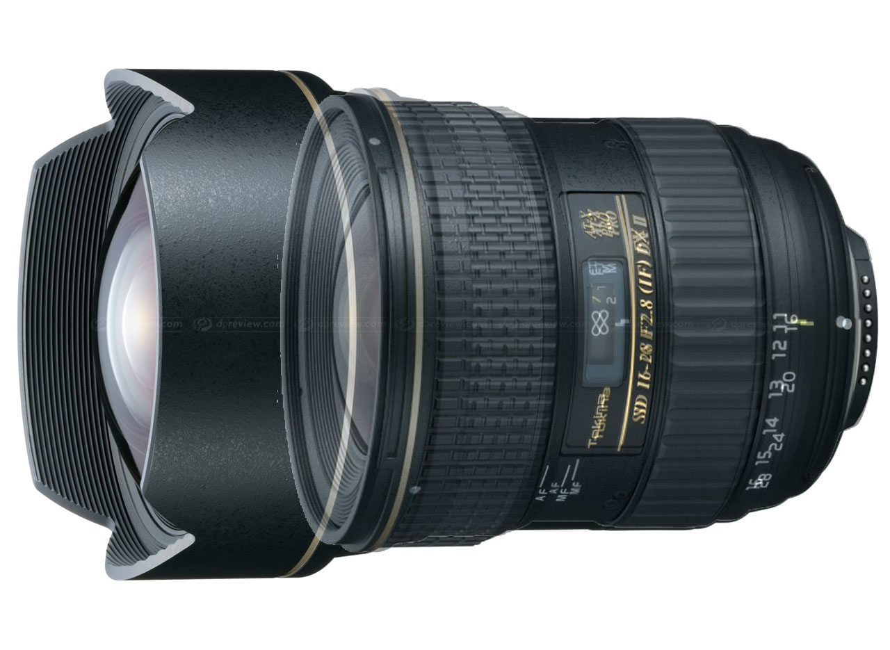

    Dave, I don't have the lens available for physical measurement or for testing on our own optical bench, so no data, but in a very non scientific way, I overlapped a picture of the Tokina 11-16mm over the Tokina 16-28mm in the Nikon version, they have multiple electronic contact points just behind the lens mount that are both very precisely located on all lenses and very helpful as reference point, when I match the contacts position, I come up with what seem to be the same zoom ring size, so a 18722 gear would be a good start in my opinion.

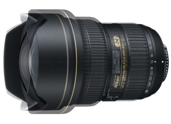

    About the port extension, I did the same, overlapped a picture of the Nikon 14-24mm over the Tokina 16-28mm using the same electronic contacts as reference, I come up with a Tokina lens that is +/- a few millimetre (looks like 5mm) longer than the Nikon. So my hunch would be for # 18458 (same as the 14-24mm).

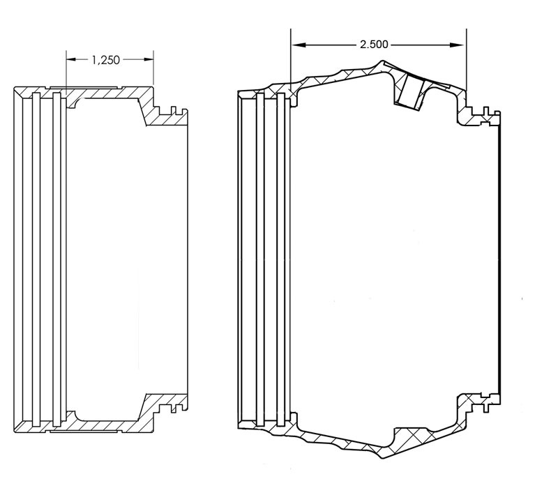

    Also, could you please tell me the length of the standard macro port (18428) and the low profile macro port (18429), in terms of distance from the bayonet mount to the glass? I'm also trying to figure out whether I'd be able to use different lenses behind one without needing many different extensions. I.e. Using the 28mm or 50mm primes, or adding a teleconverter to the 100mm macro, I'd like to try to calculate whether I'd get vignetting due to the port being too long, or have the lens hit the glass due to it being too short.
    Thanks.
    Edited by Dave S
  11. Hi Daves, here are the dimension, from the flange of the housing to the inside of the macro port lens, you have:
    18429 = 1.25"
    18426 & 18428 = 2.50"
