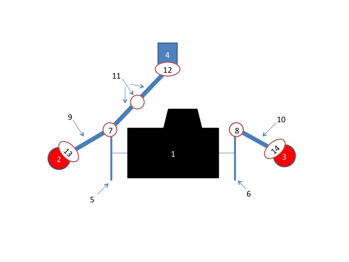

  2. Looks like a well thought out setup. It seems you are more interested in video. Given your lens of choice typically 2 strobes would be the optimal for WA, CFWA shooting. Don't forget you can mount some of your lighting on the housing itself. Triple clamps are also a option. Here is one way to set-up 6863519943_ce51c6be2e_b.jpg[/img]

  5. Hello Drew,
    Thank you for your answer. So, you mean that the end of the arms would look like the picture attached (at the bottom right)?
    If so, which length for the arms would you recommend? 1 x 30cm arm + 1 x 20cm arm on both sides?

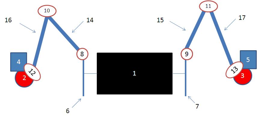

  10. So, I updated the configuration :
    1. Sony Nex 5N + 16mm Pancake + Fisheye or wide angle + Nauticam housing + 36125 E mount 4.33' fisheye port
    2 and 3 : Dragonsub videolux (video lights)
    4 and 5: Strobes: sea and sea YS-110A (or YS D01...)
    6 and 7 : Nauticam double tray
    8 and 9 : 2 Nauticam balls + 2 simple clamps
    10 and 11 : 2 simple clamps
    12 and 13 : 2 x multiple clamps + 2 sea and sea adapters + 2 Ultralight universal focus adapters
    14 and 15 : 2 x 20 cm arms
    16 and 17 : 2 x 30 cm arms
    Extras : 2 x optic fiber in order to link the housing to the strobes
    What do you think??
