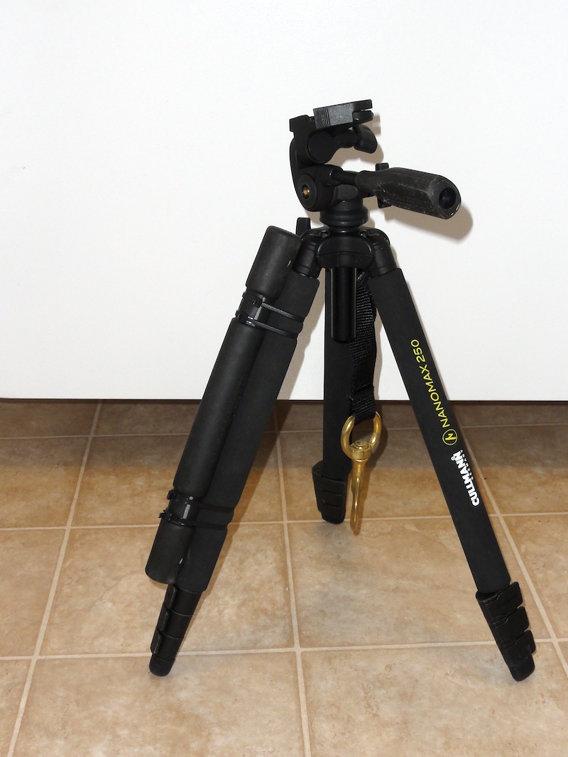

  3. OK, here are all the parts:

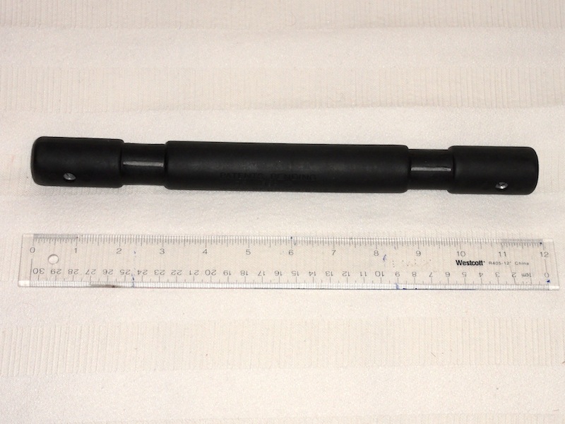

    The weights (~$14 each):
    The tripod (~$50) with one weight attached, as well as the ring, strap and quick release clip I use to attach it to my BCD when not in use (~$15 in any dive shop):

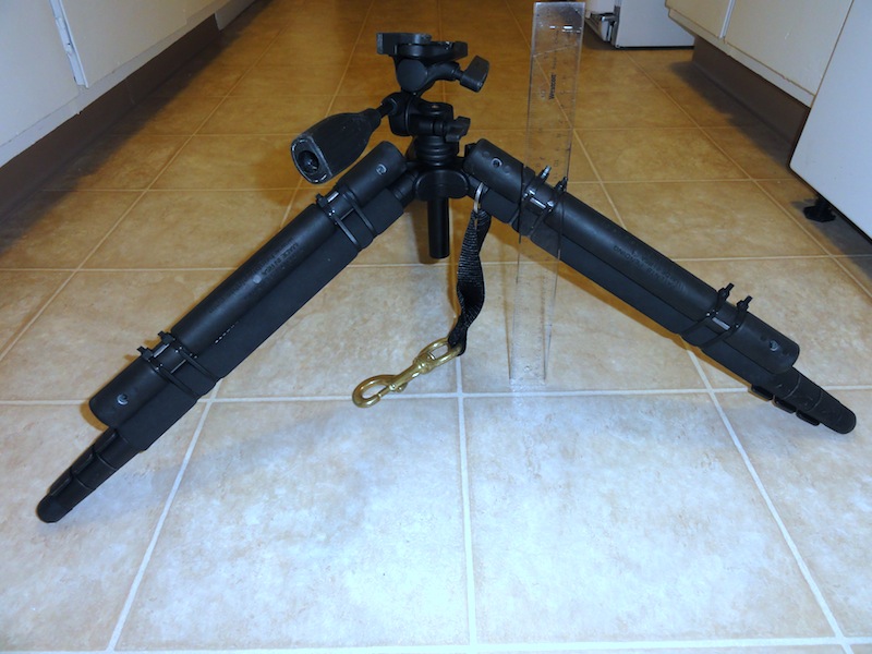

    The tripod with the weights attached to the legs (using inexpensive cable-ties). The ruler shows a top height of 11" in the "spread leg" configuration:

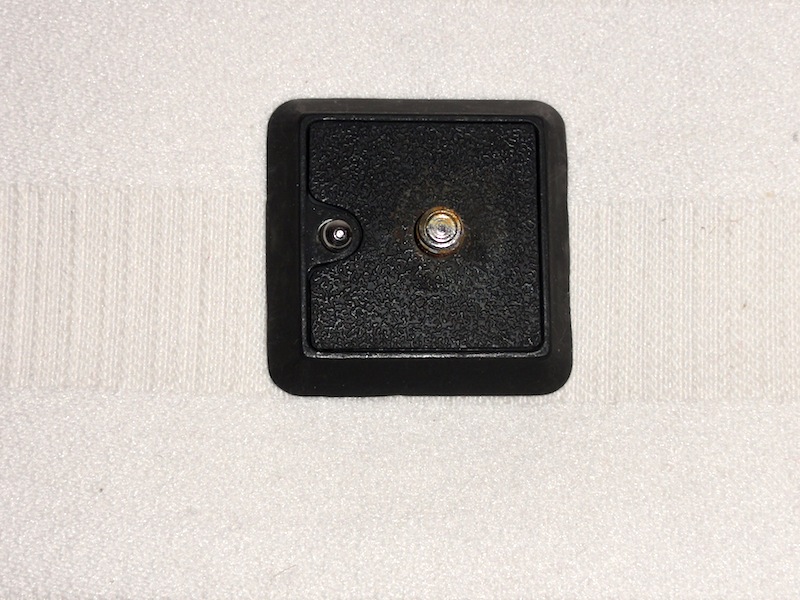

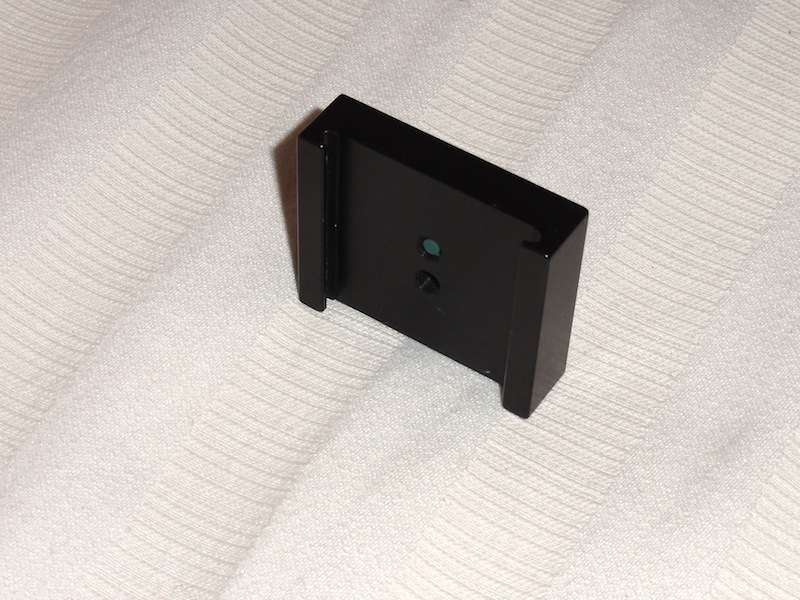

    The L&M tripod adapter (~$50. I know... but this allows you to attach the housing to ANY tripod):

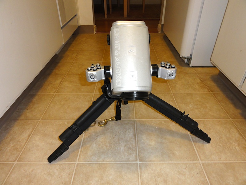

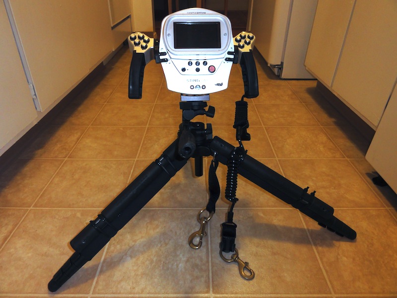

  4. And finally a couple of pictures with the housing installed (using the tripod head adapter shown next):
    Rear view with the housing tilted down ~45 deg, resulting in a ~12" distance from flat port to ground.
    Front view with the housing fully tilted down, resulting in a ~7" distance from flat fort to ground.
  5. A few comments are in order:
    - you may have noticed some rust on the tripod adapter. There are actually a few other places where I have seen some too, and I did not expect anything else, considering that it is NOT an underwater tripod. However, I don't see that this will compromise the functionality of the tripod.

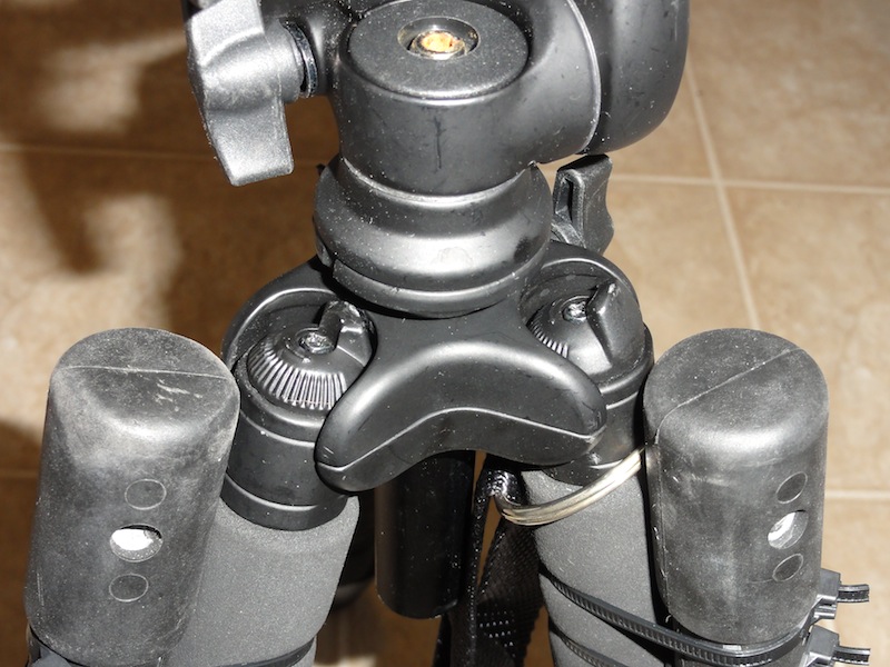

    - the legs have a simple yet clever mechanism at the top which allows selecting the "Spread leg" configuration shown in the pictures above, or the "Straight legs" one, which one might want to use for a wall shot (possibly). Here is how that looks like:
    One basically rotates the little knob at the top (big fingers bad luck) 180 degrees. They lock in place with the help of a little ball and spring mechanism (I took it apart to check this out).
    - that brings another worthy comment: this is German quality and you can take this thing apart and put it back. It will work (this is how I managed to slide the ring/strap/clip shown in one of the pictures above).
    - Of course, as for any topside tripod, you have about 3-4 ft of extensible telescopic legs at your disposal, if needed (and that comes handy if the topography is not level, for instance).
    - the tiltable head controls are not of the highest quality, but good enough for the job, at least with my housing being approximately neutral with its lights attached.
    - I removed a detachable central rod that you can crank up or down to raise the tiltable head, as I obviously don't need that extra degrees of freedom, and moreover, it did protrude downwards (you need to remove it to switch to the "Spread leg" configuration).
    The remaining part (visible in some pictures) is locked tight to the tripod, but I would not trust this to carry the weight of the tripod, hence my solution to carry it from one leg.

  8. Revisiting this old thread to conclude.
    The permanent weights idea was a bad one. Way too heavy to carry along and a potential buoyancy hazard.
    Instead, I strapped one metal ring to each leg and carried 3 clippable two-pound weights which I have on my BCD when swimming around (after removing the corresponding weight from my BCD pockets), and clip onto the tripod when setting up a shot. The weights are not necessary for my buoyancy at depth, so I simply need to dump some air from my BCD when I set up the tripod. When I want to move to some other place, I unclip the weights one at a time and add a bit of air in my BCD to compensate. I suppose that in a less surgy environment, less weight would be necessary to stabilize the rig.
